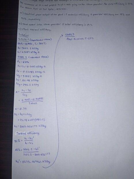

determine:
a) Electrical power output of the plant if mechanical efficiency & generator efficiency
are 88 % & 92 %, respectively.
b) Heat added in the steam generator if boiler efficiency is 85 %
c) Plant thermal efficiency
Rankine cycle
Is this the right path in solving this problem? Am i finding the correct enthalpies? I am also having difficulty understanding so what I've understood is that in a rankine cycle P2=P3 but here P2 is given and P3 has a given variable which is T=25 C too so should I neglect P2=P3?
Heres my problem set and the attempt to solve it:
In a Rankine cycle power plant superheated steam enters the turbine at 18 MPa and 580 C. Steam expands through a single stage turbine and discharges at 6 kPa with stage efficiency of 82 %. The condensate leaves the condenser at 25 C and pumped to 18.5 MPa going to the steam generator. The pump efficiency is 77 %. For steam flow of 9,000 kg/hr, determine:
  • Electrical power output of the plant if mechanical efficiency & generator efficiency
  • are 88 % & 92 %, respectively.
  • Heat added in the steam generator if boiler efficiency is 85 %
  • Plant thermal efficiency
Any help would be much appreciated, thanks
Handwritten solution to a Rankine cycle power plant problem, with state 1 superheated steam at 18 MPa and 580 C, state 2 at 6 kPa, and a turbine efficiency calculation.
  • Handwritten solution to a Rankine cycle turbine problem, showing state 1 at 18 MPa and 580 C with enthalpy and entropy values, state 2 at 6 kPa with quality x = 0.77, and turbine efficiency calculation for h2'.
I don't quite understand this part: "The condensate leaves the condenser at 25 C and pumped to 18.5 MPa going to the steam generator. Does this mean the pump compresses the steam at 25C and 6 kPa to a pressure of 18.5 MPa and then that steam/hot water is heated in the steam generator at constant volume? If so, how does this result in steam exiting the steam generator at 18 MPa?
