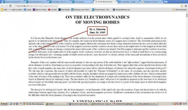

A good article. But's rather hard for me.
http://fourmilab.ch/etexts/einstein/specrel/www/
What, by Einstein himself?? No surprise, it's hard for me.:eek:
Btw, is this "the" 1905 SR paper that he first published?
The intro should not be too hard, and IMHO most textbooks give a less good introduction.
Yes it's that one (only, this is a translation as the original was in German). :smile:

Stephanus said:

Stephanus said:
Yeah, until it hits Maxwell - Hertz. [..]
With "intro" I meant the text until §1, which is exactly what you showed a picture of - no Maxwell-Hertz in that portion. :smile:
