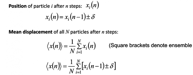

Hello!
I'm struggling with a probably easy physics question concerning random walks. Here I have the slide regarding this:
Delta is the distance that a particle moves.
Can someone explain where the n-1 initially comes from? Does it have to do wtih the concept of the degrees of freedom?
Than you already! Regards, Vera
Not sure if I understand the question. So your first equation states that after ##n## steps the particle is at the position it was after the previous step (which is the ##(n-1)##th step) plus some ##\delta##. If you put in ##n=1## you get that the position after the first step is the initial position plus some ##\delta##: ##x_1(1) - x_i(0) \pm \delta##. Every next step a new ##\delta## is added, so of course the position after ##n## steps depends on the position after ##(n-1)## steps. Why do you think this has to do anything with degrees of freedom?
After ##n-1## steps, particle i is at position ##x_i(n-1)##.
One step after that, at step ##n##, particle i has moved by ##\pm \delta##: therefore ##x_i(n)=x_i(n-1)\pm \delta##.

Oh okay, thank you. After some thinking ad not giving that much emphasis of on this n-1 (which so muchly looks like the n-1 from the df concept) I finally realized what both of you mean ;) I was really confused about why suddenly this n-1 would appear. But its probably quite reasonable. oO Thanks a lot!

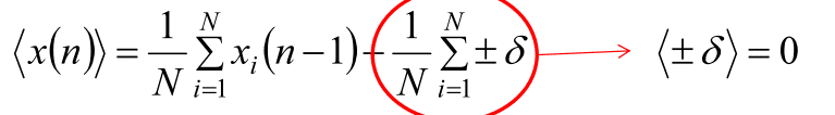

Another question:
Equation 1.) is followed by equation 2.). In equation 2.) the delta is treated separately as encircled in red colour. Is this just a process of pulling the expression after the sigma sign in equ. 1 apart?
But then, why is the second expression (in the circle) SUBTRACTED from the first part of equ. 2.)? I know it doesn't really matter as delta is 0... but just assume that the encircled expression without the minus in the beginning would equal a positive number. Then the outcome would be different compared to when the expression was negative. I know there's a mistake in thinking but I I just can figure out what's behind this. ^^
1.)
2.)
Just how I'd approach this: The first part of equ. 2.) is the average of all preceding steps (n-1) and the second part is the average of all distances after one step. Then, if I subtract all deltas and assume their average was negative (which just means this whole particle is moving in the opposite direction compared to a positive delta) this would result in a position (x) actually in the opposite direction of the negative delta average for it is subtracted from the first average...
Is that right or complete bullsh**? ;) Thanks!
