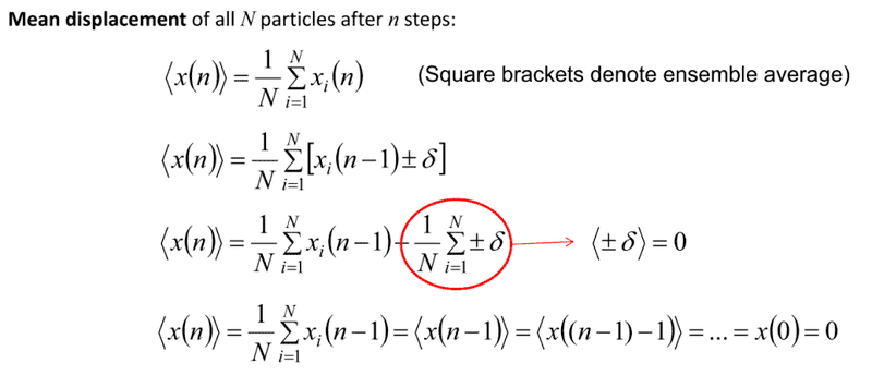

Can someone retrace this easy random walk calculation?

Okay, it's not easy for me but probably for you ;)
Hello first of all!
I have two questions:
1. Why is there a minus before the expression in the red circle?
2. How did the x((n-1)-1) in the last line come to be?
More precise: I understand the first parts. It's the random walk and x signifies the position of a particle after n steps. Then (n-1) ist the position of the particle having moved to either the left or right side (this is 1-dimensional) and the δ is the distance the particle has travelled. But why is there a minus in the third line before the second 1/N? I mean how do I imagine that visually? I kind of have a notion but I can't really grasp it. And then in the last line why is the [x(n-1)] the same as [x((n-1)-1)]? Huh? oO
Okay, here is the equation:
Thanks a lot already!
Vera

The way I interpret what they do:
Don't think it matters, as on average ##\displaystyle \sum_{i=1}^n \pm \delta = 0##
In the last line, they get ##\displaystyle \langle x(n) \rangle=\frac{1}{N}\sum_{i=1}^n x_i(n-1)##, but that is equal to ##\langle x(n-1) \rangle## (see the first formula). And then they repeat the same process down to ##\langle x(0) \rangle=0##.
Okay, I guess I got number one where the minus is simply based on the knowledge of +/- δ being zero thus having no further meaning.
And to the second problem: So does x(0) actually mean n is equal to the value which is substracted from n?
And does (n-1)-1 simply mean n-2?
Thanks!
Thanks!
I think the ##x(0)## should have been ##\langle x(0) \rangle##.
And yes, ##(n-1)-1=n-2##. They wrote it that way to emphasize that they are repeating the previous step.
In the last line, they first get ##\langle x(n) \rangle=\langle x(n-1) \rangle##. As this hold for any ##n##, it can be applied to ##n-1##, yielding ##\langle x(n-1) \rangle=\langle x((n-1)-1) \rangle=\langle x(n-2) \rangle## and so on ...
Oh I guess I have it now. Thanks lot!
Probably <x(0)> = x(0) = 0 is also true. The ensemble average on nothing (empty sum) results in nothing.
