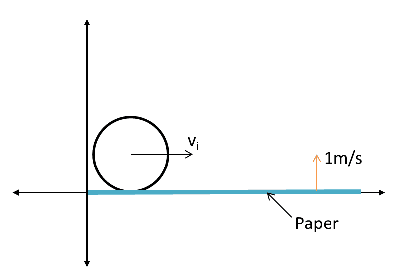

Let the table be the x-y plane and let the initial velocity of the ball be along the x axis. The paper is then suddenly pulled in the y direction.

Hi TSny! :smile:
I drew a sketch, is it correct?
How to form the equations?
Thanks!

There are two horizontal directions. The ball is rolling along one of those, the paper is moved along the other
The paper slides along the table in a direction perpendicular to the initial velocity of the ball. In your diagram, you would pull the paper either towards you (out of the screen) or away from you (into the screen).

I thought some more upon the problem. Please look at the attachment.
The green colour denotes the paper and the purple for sphere.
The ##v_i## remains unchanged as there is no force in that direction. The friction acts in the direction of paper's velocity.
Now I am confused at one point. I can easily find the velocity of sphere in the direction of paper's motion as ##f=\mu_k mg##. Also, there will be angular velocity generated in a direction different to the initial one, so the final angular velocity is obtained by the resultant of two angular velocities. But then where do I need the coefficient of static friction (##\mu_s##)? :confused:
Am I heading in the correct direction?
I agree with the outline of the solution. I do not think that static friction could play a role in this problem.
Maybe you won't need ##\mu_s##. You'll have to work out the problem to see.
I think you are heading in the right direction.
