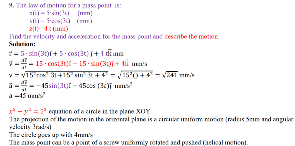

Describe the motion of a mass point with a given law of motion
I've attached a picture
So I've done the first part of the problem, I just need to understand the x^2+y^2=5 part. I believe in order to get to this (I think this is called the trajectory equation, but please correct me if I'm wrong), we wrote sin(3t) = x/5 and cos(3t) = y/5, we raised each of these to the power of 2 and added them. But in the solution it says that it's the equation of a circle in the plane XOY. How do we know it's the equation of a circle?
