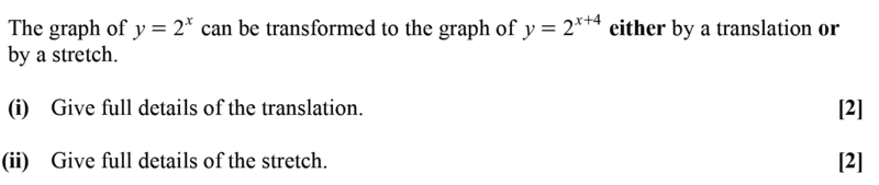

Find the translation and stretch from ##y=2^x## to ##y=2^{x+4}##
4 replies · 2K views
chwala
2,844
434
See attached...
Translation/Stretch
For part (i) i was thinking of the vertical shift from ##(0,1)## to ##(0,16)##, this can be given by;
##y=2^x + 15## but it does not fit onto ##y=2^{x+4}## something wrong here.
For part (ii), =we have a stretch factor of ##a=16>0## (vertical stretch) thus, ##y=16\cdot 2^x##
your thoughts...i do not have solutions...
pasmith said:
If [itex]f(x) = 2^x[/itex] then [itex]2^{x+4} = f(x + 4)[/itex].
Isn't this a horizontal shift... it's not exactly what we want. Unless I am missing something...
chwala said:
For part (i) i was thinking of the vertical shift from (0,1) to (0,16),
As already noted, the transformation is a horizontal translation (or shift). The original graph is translated four units to the left. The point on the original graph that was at (0, 1) is now at (-4, 1). The point that was at (4, 16) is now at (0, 16).
Yes.
On the other hand, ##2^{x + 4} = 2^x \cdot 2^4 = 16\cdot 2^2##.
Viewed this way there is a vertical stretch away from the x-axis.
