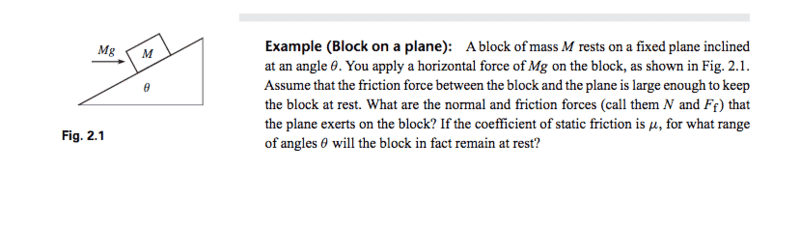

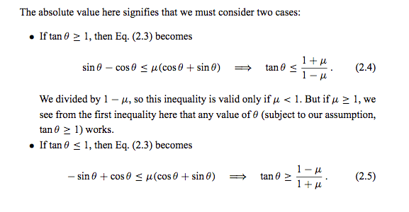

I don't understand the math here which is troubling considering I got A's in calc 2 and 3...
I tried to divide both sides by cos(theta) and solve for tantheta. but that gives something different.
Also, what does tantheta>=1 even mean? Is this second quadrant or fourth quadrant?
Thanks!

Nevermind. Got the equation for the tan>1 case (I was thinking tan>0 or tan<0 not 1).
But for the case where tan of theta is less than one, that would mean between pi/4 and pi/2. I'm wondering why sintheta becomes negative and costheta becomes positive.
Any takers?
Between -π/2 and π/4.
