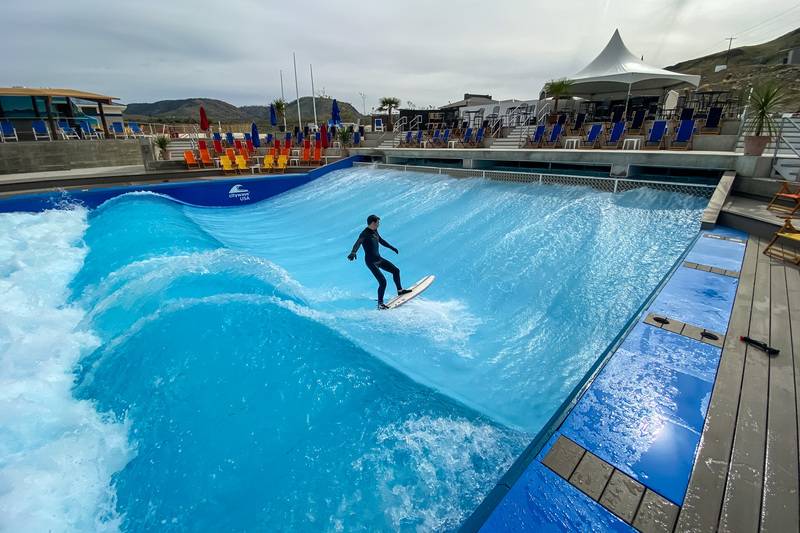

My application is not really a waterslide. That was just used as a example. My real application is in surfing and the depth is to accommodate some fins on the board so they dont just slide on the bottom plate, but actually function like they do in the open water.
Baluncore said:
Keywords are: Kapitza_instability, sheet flow, and roll waves.

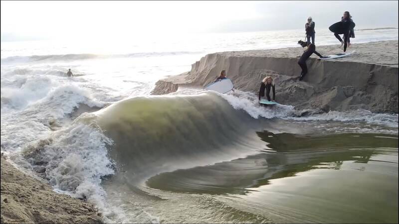

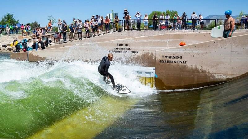

So why don't we see the roll waves in artificial wave surfing facility's?
As you can see from the inlet on the top all the way down to the bottom of the valley of the wave the water is almost completely flat, and it is a pretty thick watersheet over the floor of the artificial wave:
Man in a black wetsuit surfing a standing wave in a blue artificial wave pool, with lounge chairs and umbrellas on the deck behind.
And you can see the same on standing wave river surfing:
Surfer riding a standing wave in a man-made channel, with warning signs reading EXPERTS ONLY on the concrete walls and spectators watching from a railing above.

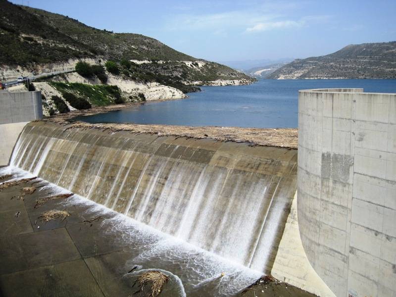

Even dam overflow's have a pretty flat sheet of water over the concrete floor:
Water pouring over the curved concrete crest of a dam spillway into a reservoir, with the lake and hills visible behind and a concrete wall on the right.
They are there, but they have been minimised because otherwise they would hit the surfers and make it difficult to ride. The paper by Ponce V M and Guzmán B C shows how to minimise roll waves. Watch the figure 18 video to see what happens given a sufficiently long run.
If the water was flat, you would see a reflection in it, but it is covered with small waves that have not yet, because of the short slope, had time to self organised into roll waves.
Look at the foot of the dam wall, where there are patterns on the flat concrete, made by roll waves falling down the steep face of the dam wall.
