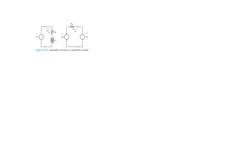

For the textbook diagram of a separately excited dc motor, the voltage equation for the armature circuit is given as
##V_t=E_a + I_aR_a##

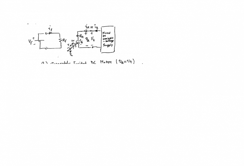

But in the class notes, it says ##V_t = V_a##
Firstly, I don't know if the ##V_a## refers to the induced armature voltage ##E_a## or the ##I_aR_a##.
But either way, according to the voltage equation, shouldn't the two not be equal?

From the hand-drawn diagram, it's pretty clear that ##V_a = E_a + I_aR_a##.
The coils of the armature is represented by a pure inductor and a resistor in the equivalent circuit.
Going round the circuit we come to the conclusion that the supply voltage Vt is
Vt = Ea + Ia Ra
where Ea is the voltage over the pure inductor.
Next they introduce a "new" variable, the voltage drop over the armature as a whole Va .
Clearly this has to be equal to the supply voltage Vt .
