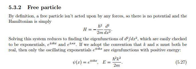

Hi everybody,
I was reading about the free particle in a textbook and I got confused by the line:
"If we adopt the convention that k and k are real, then the only oscillating exponentials are the eigenfuntions with positive energy" [Also see the attached picture with the paragraph.]
What is the rationale for that line? Furthermore, does anybody have a link where I can read about those exponentials? I couldn't find them online and I am curious to know how and when they are used to solve the Schrodinger Equation!

I don't doubt that they satisfy the equation. My question is about the line,
Why is there a need for both k and kappa be real? And what are those exponentials e^(+-ikx) and e^(+-kx) called and where can I read more about them?

Because if they are not real, then it is difficult to separate the two cases. For instance, an imaginary κ would correspond to a real k.
I don't know of any particular name for these exponentials. They come from the mathematics of differential equations.

If you let ##k## be complex, then you get all the solutions with ##k^2 = -\frac{2mE}{\hbar^2}## hence:
##k = \pm i \frac{\sqrt{2mE}}{\hbar}##
And:
##\psi(x) = Ae^{\pm i \frac{\sqrt{2mE}}{\hbar}x}##
So, it amounts to the same thing. Taking ##k## as real initially is just a bit of a shortcut, based to some extent on knowing the solution in advance!

What's the source? It's very inaccurate.
The rationale is the following: In wave mechanics the vectors of the quantum mechanical Hilbert space are represented by square integrable functions ##\psi:\mathbb{R}^3 \rightarrow \mathbb{C}##. The position vector ##\vec{x}## is represented by the multiplication of the wave function with ##\vec{x}##, and momentum by ##\hat{\vec{p}}=-\hbar \vec{\nabla}##.

These generalized eigenfunctions do NOT represent states since they are not square integrable, but you can describe all wave functions in terms of generalized momentum eigenstates:

I agree the wording is odd. The time-independent SE leads to a time part of the solution of the time-dependent SE of the form ##\exp({-iEt/ \hbar})##. The continuity equation forces ##(E-E^*) = 0## so E is real.
Then: with the most general form, a complex ##e^{{\bf \alpha} x} ## where ##{\bf \alpha} = \kappa + ik \ \ ## (##\kappa## and ##k## real), you get from the time-independent SE: ##\ \ -{\hbar^2\over 2m}{\bf\alpha}^2 = E\ ## . Positive, real-valued E requires ##\kappa = 0##.
As vanHees points out, these are solutions, eigenfunctions of the Hamiltonian. They are not physically realizable states (not normalizable). But that is (I expect) a subject further on in your curriculum.
Likes majormuss and vanhees71
That the plane waves are not representing states, is a very important point. A lot of confusion arises from not making this very clear in the very first encounter of these generalized solutions of the Schrödinger equation!
