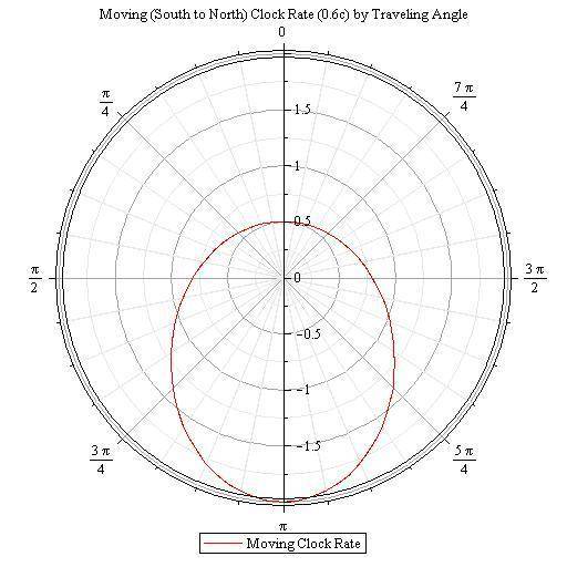

Here is a graph showing what an observer actually sees or measures about a moving clock traveling at 0.6c.
At the top of the red curve you see a rate of 0.5 indicating a clock moving away from the line of sight. At the bottom of the red curve you see a rate of 2 indicating a clock approaching from the line of sight. At the extreme left and right of the red curve, which represents transverse movement, you can see that the clock rates are identical to the calculated time dilation based on the Lorentz factor (gamma).
