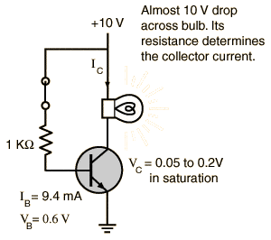

But this lead me to a another question, how does saturation region takes it part in transistor? I vaguely understand what it is, I know that both E and C are forward biased.
A NPN transistor in saturation will still have a collector voltage a few tenths of a volt above emitter voltage and will provide a large current useful for "switch on" applications like this:
http://hyperphysics.phy-astr.gsu.edu/hbase/electronic/transwitch.html#c2"
I will check those links out. Thanks, will come back with hopefully better understandings.
From a circuit point of view saturation is rather like a water tap (faucet). There comes a point where you cannot turn in on any further.
Does this mean you push the current through base so much, that the resistor on the collector wire picks up so much current that it drops the voltage so the collector becomes forward biased?
Notice that the equation for determining the collector current from the base current in post 2 above using β is dependent on the base to emitter voltage, the collector current, and the temperature for any particular NPN transistor. The actual equation for determining the collector current is
So yes, there is a limiting collector current which is equal to the saturation current. Of course one could increase the potentials so as to "blow" the junctions; hence no collector current.
