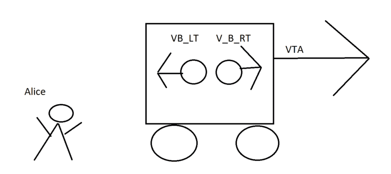

Bob is standing in the middle of a train moving at velocity v at constant velocity in the right direction. Bob throws 2 identical baseballs in opposite direction at the same speed at a constant velocity on the train. From Alice perceptive on the ground what is the velocity of the train?
q2
Now imagine I have 2 people running at a constant velocity towards each other in the same direction lets call the person on the left Alice and the person on the right Bob. Calculate from Alice's frame and Bob's frame the constant velocity?
q3
Now imagine I have 2 people running to the right in the same direction located at different locations let's call the person on the left Alice and the person on the right Bob. Calculate from Alice's frame and Bob's frame the constant velocity?

The first answer is not correct. Let's say the train is moving at a speed of 5A along the x-axis in the positive direction (towards the right). Let's also say that Bob throws each baseball at a speed of A in opposite directions along the x-axis with respect to the train.
The velocity of each ball is the sum of the train's velocity with respect to the ground and the balls' velocities with respect to the train.
Left ball with respect to ground: Vlbg = Vtrain + Vlbt = (5A,0,0)+(-A,0,0) = (4A,0,0). The left ball is moving to the right at a speed of 4A with respect to the ground.
Right ball with respect to ground: Vrbg = Vtrain + Vrbt = (5A,0,0)+(A,0,0) = (6A,0,0). The right ball is moving to the right at a speed of 6A with respect to the ground.
The velocity of each ball with respect to the ground is in this case just simple vector addition. This is NOT the case for your next two questions. Questions 2 and 3 are about Galilean transformations, not just about finding the speed of two objects with respect to the same inertial frame.

rgtr said:
v_left_ball = v_left_ball - v_train
The correct way to proceed algebraically is to subtract v_left_ball from both sides of the equation and end up with 0 = -v_train which is nonsense. The way to deal with relative velocity problems is to use double subscripts to denote what the velocity of what is relative to what. In this case, one would define
##V_{\text{TA}}=## velocity of Train relative to Alice. (Bob is at rest w.r.t. the train so he doesn't count.)
##V_{\text{1T}}=## velocity of ball 1 relative to Train
##V_{\text{1A}}=## velocity of ball 1 relative to Alice.
The pattern that you are looking for is to say that one of these terms is the sum of the other two. To know which two are added, look at the subscripts and find the subscript that appears both on the left and on the right. Add these two and set them equal to the third velocity. In the above example you see that "A" is only on the right, "1" is only on the left but "T" is on the left and on the right. Therefore,
##V_{\text{1A}}=V_{\text{TA}}+V_{\text{1T}}.##
An additional rule is ##V_{\text{BA}}=-V_{\text{AB}}.## This comes in very handy in case you end up with ##V_{\text{AB}},~V_{\text{BC}},~V_{\text{CA}}## where all the three subscripts appear on the left and on the right. You swap one pair and have ##-V_{\text{BA}},~V_{\text{BC}},~V_{\text{CA}}## to break the symmetry. Then you have "C" only on the left and the right so that you can write ##-V_{\text{BA}}=V_{\text{BC}}+V_{\text{CA}}.##
This sets up the equation. With a little algebra, you can find anyone of the three velocities if you know the other two. It doesn't matter which pair you swap; the equation that you get will not be new.

Sorry I took a break from physics for a while I got busy and just have a followup/ confirmation question.
Where ball 1 or B_1 is the left ball. Also obviously Alice is on the ground seeing the train move at velocity v in the right direction.
## VPA = VTA -(VB_1A) ## , when using velocity addition on the right hand of the equal sign does the right hand of the equal sign always need to equal the same frame unless performing algebra and changing it to plus? That kind of trips me up? What I mean is ## Vxy = Viy - Vty##? Just assume I used random variables for ## Vxy = Viy - Vty##.

Sorry I was multitasking while posting the first time.## VBLA = VBLT + VTA ## =
## VBLT = VBLA - VTA ##
When using the example ## VBLT = VBLA - VTA## velocity addition on the right hand of the equal sign of the equal sign, does the right hand of the equal sign always need to equal the same frame unless performing algebra and changing it to plus? I guess it could be a minus also but you get what I am saying.
I would advise you to be consistent and use only two subscripts only and also not to string letters one after the other. For all I know ##VBLT## could stand for "vegan BLT sandwich." I get what you are trying to say, but it should be self-explanatory. This is how I would it.
1. Start with clear definitions of what stands for what.
##V_{\text{LT}}~##= velocity of the Left ball relative to the Train.
##V_{\text{RT}}~##= velocity of the Right ball relative to the Train.
##V_{\text{TA}}~##= velocity of Train ball relative to Alice.
2. Decide what you wish to find and write it down. Say you want the velocity of the left ball relative to Alice.
##V_{\text{LA}}~=~?## The velocity of the right ball is irrelevant to this. You see that the letter "T" appears on the left and on the right in the subscripts which means that you connect the corresponding two velocities with a "+" sign and set the sum equal to the other velocity:
##V_{\text{LA}}=V_{\text{LT}}+V_{\text{TA}}.##
This equation says that the velocity of the left ball relative to Alice can be obtained by adding the velocity of the left ball relative to the train to the velocity of the train relative to Alice.
It is correct to algebraically move one term to the other side, change sign and write
##V_{\text{LA}}-V_{\text{LT}}=V_{\text{TA}}.##
What does this say? Well, you can swap left and right hand sides in the equation to have only one velocity on the left.
##V_{\text{TA}}=V_{\text{LA}}-V_{\text{LT}}.##
You can also eliminate the negative sign by swiping subscripts in the second term. That's because ##V_{\text{LT}}=-V_{\text{TL}}## which says the obvious: if the ball sees the train move in a given direction with a given speed, the train sees the ball move in the opposite direction with the same speed.
So finally the equation is transformed to
##V_{\text{TA}}=V_{\text{LA}}+V_{\text{TL}}.##
Note that this equation obeys the rule that the same subscript appears both on the left and on the right in the velocities that are connected with the "+" sign. It says that the velocity of the train relative to Alice is equal to the velocity of the left ball relative to Alice plus the velocity of the train relative to the left ball.

##V_{\text{LT}}=V_{\text{LA}}+V_{\text{AT}}.##
Put in the known numbers and solve
##-5~\rm{m/s}=15~\rm{m/s}+V_{\text{AT}} \implies V_{\text{AT}}=-25~\rm{m/s}.##
Answer: Bob sees Alice moving to the left with a speed of 25 m/s.
Finally, if it so happens that you are given and what you are looking for have double subscripts which are symmetric, i.e. all three letters appear both on the left an on the right, then swap subscripts in one velocity (doesn't matter which) and change sign to break the symmetry.
Do you see now how it all works?
