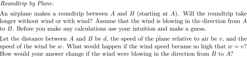

Given below.
Equation for relative velocity may be required (Given below).
The question I have is that if the aero plane is traveling in the same direction as the wind, would it not increase its velocity, as in with boats and streams? So, if by chance, ##w = v##, then the velocity of the aero plane would double. It feels weird as going by the same logic, if the speed of the wind happens to be in opposite direction, then the plane would be at rest. There is something wrong with my intuition/logic, is there not?
And one more thing. The speed of the plane relative to the air is ##v##. Does this mean that the speed of the plane is ##v## w.r.t. a person standing on ground or is it that speed w.r.t. the wind blowing?
I can not start solving the problem before I can understand the answers to these questions.

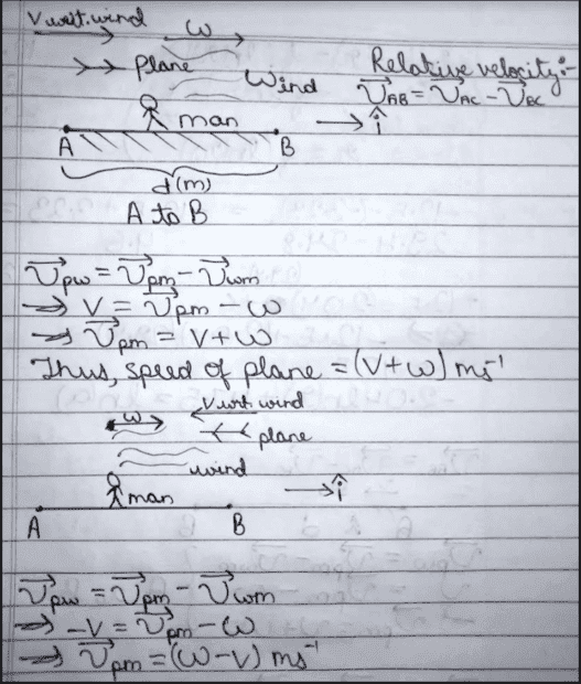

Is my work till here correct?

Why do we not discuss the topic at hand? Is the procedure I followed correct?
You have correct expressions for velocities, but speed is not a vector. What is the speed in the direction B to A, assuming the plane can actually get there?
Also, next step is to consider the round trip time.
Did I not already calculate the speed from B to A, which is ##w - v##? Since this is 1D motion, the signs take care of everything, like direction.
So I need to use the formula $$Distance = Speed \times Time$$ for both the cases and add the times.
Am I correct in doing this?
brochesspro said:
Did I not already calculate the speed from B to A, which is w−v?
Can speed be negative? What will happen if w-v is positive?
Note that ##w - v## is a vector. ##w## is in the positive direction and ##v## is in the negative direction. So basically, we have to look at the magnitude of the vector difference. Thus, the speed is ##| w - v |##.
Am I right?
Am I right?
w and v are given as speeds, not vectors. If we assume the plane can get back to A, how can we simplify | w - v |?
Since this is 1D motion, we can write the velocities in the form of vectors.
Am I wrong to think so?
This is another version of the work I did after starting fresh. How do you think it fares? I think there is something fishy about it but I just can not seem to point my finger at it. Please evaluate it, @haruspex. Thank you.
The result, ##\frac{2dw}{w^2-v^2}## has some of the right behavior. But yes, it is fishy. Somehow the variables seem to have been swapped.
One assumes that ##w## is the wind speed and that ##v## is the airplane's velocity relative to the air.
If ##w=v##, ##w^2 = v^2##, the denominator becomes zero and an infinite round trip time is computed. This makes sense since the upwind leg of the journey will indeed take forever.
If ##v=0##, we get a result of ##\frac{2d}{w}##. That would be the correct number for a round trip at velocity ##w##. But ##w## is the wind speed.
Let us back up and see if we can spot the error...
You start with some stuff that I find hard to follow because you are not documenting your variable names. That is a pet peeve of mine. Slowing down to decipher that, I get:
##\vec{V_\text{pw}}## is the velocity of the plane with respect to the wind.
##\vec{V_\text{pm}}## is the velocity of the plane with respect to the mass of the Earth (I guess).
##\vec{V_\text{wm}}## is the velocity of the wind with respect to the mass of the earth.
You assert that the velocity of the plane with respect to the wind is the vector difference between the plane's velocity and the wind's velocity, both relative to the fixed ground frame: ##\vec{V_\text{pw}} = \vec{V_\text{pm}} - \vec{V_\text{wm}}##. That is a valid assertion.
You then carefully look at your sign conventions and use the positive speed ##v## to replace ##\vec{V_\text{pw}}## and the positive wind speed ##w## for ##\vec{V_\text{wm}}##.
The conclusion is that the plane's ground velocity (##\vec{V_\text{pm}}##) for the downwind leg is ##v+w##. Indeed, that seems obviously correct.
You proceed to re-use the same variable names for the upwind leg. Again, you are careful with the sign conventions. This time the plane's velocity relative to the ground is the negation of its ground speed.
The conclusion is that the plane's ground velocity (##\vec{V_\text{pm}}##) for the upwind leg is ##w-v##. This is the negation of ##v-w## and since the plane is leftward moving this time, that seems obviously correct again.
Ahhh, there it is. I think I see the error.
You assert that the total time is the sum of the downwind flight time plus the upwind flight time. But before writing that assertion down, you immediately rewrite the downwind flight time as ##\frac{d}{v+w}## and the upwind flight time as ##\frac{d}{w-v}##.
But that second term is not correct. The displacement to be traversed is not ##d##. It is ##-d##. A negative displacement covered at what will (hopefully) be a negative velocity.

Thank you a lot for your hard work in writing your answer. I have a request. I will write my answers to the questions asked in the problem. Please evaluate them and correct my errors, if any.
a) The roundtrip will take greater time with wind, as the time taken with wind is ##\frac {2dv} {v^2-w^2}##, while the time taken without wind is ##\frac {2d} v##. On evaluating, the former is greater than the latter.
b) If the wind speed became so high that ##w = v##, the speed when traveling from B to A would be zero and hence, the object would not move.
c) If the wind direction is reversed, then the situation is the opposite of before. Now, the speed while traveling from A to B would be zero and the plane would not move.
That is it. See you in about 8 and a half hours.
I see you at last have the signs right. @jbriggs444 corrected it by taking the fully vectorial view and noting that the B to A displacement is -d. I had been trying to get you to see that in the speed and distance view the return speed is v-w, not w-v. Same result.
One could describe your error as mixing the two views, treating v and w as vectors but d as a distance. A useful lesson.

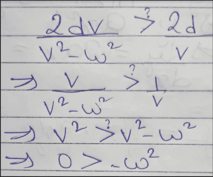

Does that mean you tried some specific numbers? It wouid be more persuasive if you could show it is always greater (under certain assumptions).
I will be careful from next time onwards.
haruspex said:
Does that mean you tried some specific numbers? It wouid be more persuasive if you could show it is always greater.
Is this not enough to prove that the time taken to travel with wind is greater than the time taken to travel without wind? In the last step, ##w^2## is always positive, and hence, ##-w^2## is always negative, and thus, by definition, less than zero. Thank you for your effort.
Am I right in doing so?
brochesspro said:
I will be careful from next time onwards.View attachment 295135
looks good. Note that your algebra (second step) assumes v>0 and v>w (or neither).
So all my answers to the original problem statement are correct, or are there any errors?
Looks fine.
haruspex said:
Looks fine.
