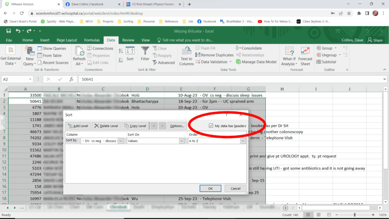

When I try to sort a spreadsheet, it ignores the first row (not a header.)
I'm trying to sort this sheet in Excel. I want to sort it on Column D.

Now I Data > Sort which brings up a dialogue where I specify the column I want to sort by :
Excel Sort dialog over a spreadsheet, sorting by Column D in A to Z order with My data has headers checked; the first data row appears unselected.
(I can already tell there may be a problem - the first row has become deselected. This was not my doing. It happens every time):
Excel window titled Missing Bills.xlsx with the Sort dialog open, Sort by Column D, Values, A to Z; row 1 is outlined in red and the rest of the sheet is selected.

What am I doing wrong?
[ UPDATE ]
Man there is nothing so effective for trouble-shooting as writing up the problem unambiguously in preparation for asking for help... :sorry:
When I went to update the veeery last screenshot, I saw this:
Excel Sort dialog box with the 'My data has headers' checkbox circled in red, and the Sort by column set to a column containing OV cs neg text, Values, A to Z.

Dave, I also had to track this down one time. Obvious once you know about the option but MS Office software has SO many options that it's hard to keep track of them all.
Indeed. The gotcha in this case was that it the first row's behavior hinted at being a header, but the only way to define a row to behave as a header is to "freeze" it. Which of course, I did not do.
Knowing that's how Excel "handles" headers, one would not think to go looking for an option on a dialogue that said, effectively "Don't become a header, just pretend to act like one - for the moment - and then go back to being a regular row, like nothing ever happened." :mad:
