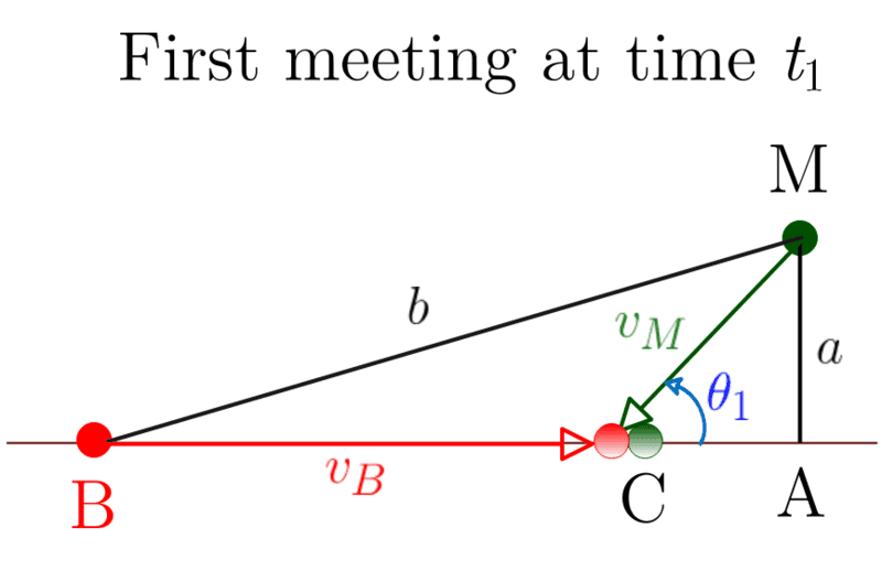

(1) Closest point of meeting : I draw the diagram where the bus B meets the man M at the point C, the closest point of meeting. Anywhere before C on the line BA, the bus will arrive before the man.
If ##v_B## be the velocity of the bus and ##v_C## that of the man, we have ##\text{BC}=v_Bt_1## and ##\text{MC} = v_Mt_1##. Since the times are the same at the point of meet, ##\small{\dfrac{BC}{v_B}=\dfrac{\text{MC}}{v_M}\Rightarrow \dfrac{\text{AB}-\text{AC}}{v_B}=\dfrac{\text{MC}}{v_M}\Rightarrow \dfrac{\sqrt{b^2-a^2}-a\cot\theta_1}{v_B}=\dfrac{a\csc\theta_1}{v_M}}##, using the the Pythagorean theorem for AB and trigonometric ratios for MC and MA in terms of ##a## and ##\theta_1##.
Putting values, ##\small{\dfrac{\sqrt{400^2-60^2}-60\cot\theta_1}{16}=\dfrac{60\csc\theta_1}{4}\Rightarrow 395-60\cot\theta_1=240\csc\theta_1\quad \color{blue}{-(1)}}##. Upon squaring both sides and using ##\csc^2\theta=1+\cot^2\theta##, I obtained a quadratic in ##\cot\theta_1## which solved to ##\small{\cot\theta_1=0.98\Rightarrow\tan\theta_1=1.02\Rightarrow \boxed{\boldsymbol{\theta_1=45.6^{\circ}}}}##.

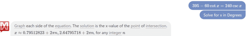

Incidentally, upon putting ##\color{blue}{(1)}## as a trigonometric equation in Mathway for it to solve for me, I got a different answer. It tells me the angle ##x=0.8^{\circ}, 2.64^{\circ}##, which are both far from my answer of ##\theta_1=45.6^{\circ}##.
Request : Where am I going wrong in evaluating the solution for the equation online?

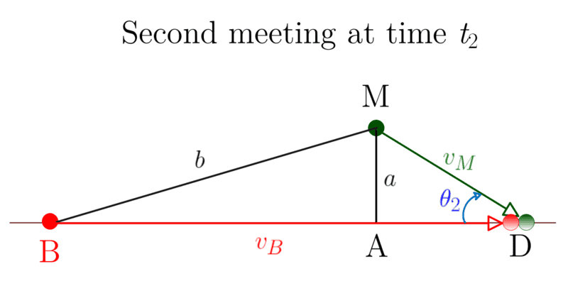

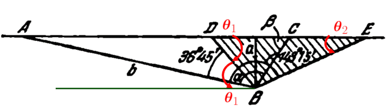

(2) Farthest point of meeting : Here the bus B meets the man M at the point D, the farthest point of meeting. Anywhere after D on the line BA, the bus will arrive before the man. The time of meeting is some ##t_2##.
Thus ##\small{t_2=\dfrac{\text{BD}}{v_B}=\dfrac{MD}{v_M}\Rightarrow \dfrac{\text{AB}+\text{AD}}{v_B}=\dfrac{\text{MB}}{v_M}\Rightarrow \dfrac{\sqrt{b^2-a^2}+a\cot\theta_2}{v_B}=\dfrac{a\csc\theta_2}{v_M}\Rightarrow \dfrac{\sqrt{400^2-60^2}+60\cot\theta_2}{16}=\dfrac{60\csc\theta_2}{4}\Rightarrow 395+60\cot\theta_2=240\csc\theta_2\quad\color{blue}{-(2)}}.## I solve it as before to get an answer of ##\boxed{\boldsymbol{\theta_2=28.3^{\circ}}}##.
This answer could be wrong too. It corresponds (roughly) to the upper limit of ##\alpha## that I underline in red ink (______).
I copy and paste the authors' working diagram below. Not only is the diagram far from clear, I am not sure how their upper limit of ##\alpha## corresponds to my ##\theta_2##.
Upon matching their answers with mine, using some triangle trigonometry, I obtain their values of ##\alpha## to be : ##\boxed{\boldsymbol{36.9^{\circ}<\alpha<143.07^{\circ}}}##. I presume these are correct approximately. Note their answers are in degrees and minutes.
Request : Is my working fine? Or am I missing something?

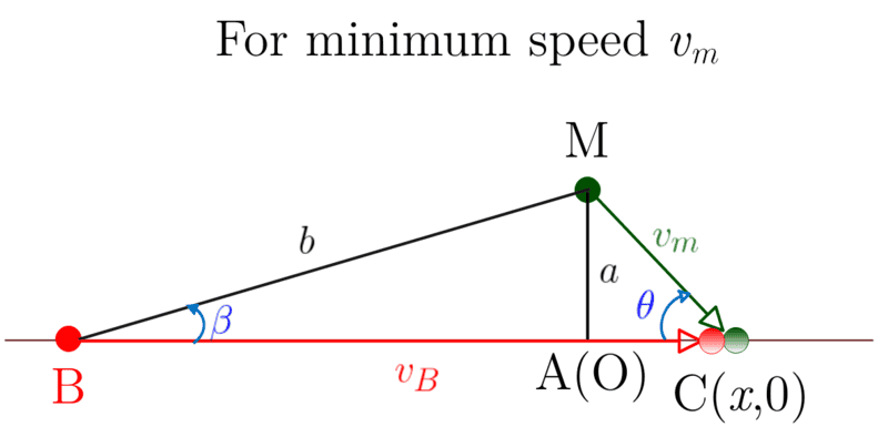

Part (b) : To find the minimum speed I had no doubts I had to use calculus.
The man moves along CO with minimum speed ##v_m## reaching C at a distance ##x## from A, taken to be also the origin O. Since both B and M reach C at the same time ##t##, ##\small{t=\dfrac{\text{BC}}{v_B}=\dfrac{MC}{v_m}\Rightarrow\dfrac{\text{AB}+x}{v_B}=\dfrac{\sqrt{a^2+x^2}}{v_m}\Rightarrow (\text{AB}+x)v_m=\sqrt{a^2+x^2}v_B}##.
I squared this expression to obtain an expression for ##v^2_m## : ##\small{v_m^2=\dfrac{(a^2+x^2)v_B^2}{\text{AB}^2+2\text{AB}x+x^2}}##.
I would differentiate this with respect to ##x## to obtain ##\dfrac{dv_m}{dx}## in a quadratic expression terms of ##\text{AB}, x, v_B##. Setting it to zero for minimum condition, the value of ##x=9.11\,\text{m}##. This would yield the direction of the man's motion ##\boxed{\boldsymbol{\theta = 81.4^{\circ}}}## and his speed ##\boxed{\boldsymbol{v_m=2.43\,\text{m/s}}}##.
These answers were correct. In the diagram above, ##\beta+\theta=\alpha##. The value of ##\beta =8.6^{\circ}## and they indeed give the value of ##\alpha## in the text.
However, the authors did not pursue a method as tortuous as mine where I had to avail myself of the methods of calculus. The immediately surmised that for minimum speed, the man should travel perpendicular to the initial line connecting him to the bus! Also, they argued that for minimum speed of motion for the man, the times ##t_1## and ##t_2## in parts (a) and (b) for closest and farthest meetings should both be the same! But how?
Request : How is that for minimum speed of meeting, the direction of travel by the man is normal to the line connecting him to the bus? How also do the times of meeting for near and far travels become the same for minimum speed of motion by the man?

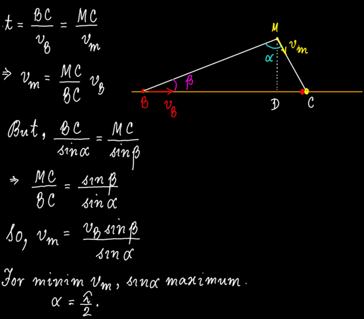

The time to meet, ##MC/v_m=BC/v_B##.
##v_m=v_B*MC/BC=v_B*\sin(\beta)/\sin(\alpha)##.
To minimize ##v_m## we need to maximize ##\sin(\alpha)##, which gets maximum at ##\pi/2##.
Excellent. Many thanks.
It seems like Mathway isn't giving the answer in degrees but in radians. LLMs (large language models) aren't perfect and often won't give the exact response you're looking for, so use them with caution.

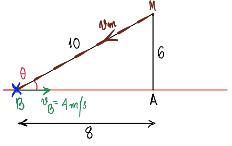

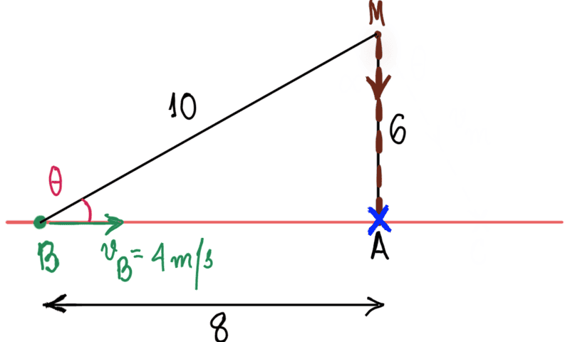

A bus B travels at a speed of 4 m/s along the highway BC. Initially, a man is located at a distance 6 m from the highway and 10 m from the bus.
(I) Minimum speed : With what minimum speed (##v_m##) and in what direction (##\theta##) should the man walk in order to meet the bus along the highway? Also calculate the time and distance travelled by the man.
Since they both meet after the same time ##t##, ##\small{\dfrac{MC}{v_m}=\dfrac{BC}{v_B}\Rightarrow v_m=\dfrac{MC}{BC}v_B}##. But ##\small{\dfrac{MC}{BC}=\dfrac{\sin(\angle MBC=\theta)}{\sin\alpha}\Rightarrow v_m=\dfrac{\sin\theta}{\sin\alpha}v_B}##. For ##v_m## to be minimum, ##\sin\alpha## should be maximum, hence ##\boxed{\boldsymbol{\alpha=\pi/2}}##. If ##\small{\alpha=\pi/2\Rightarrow\angle AMC=\theta=\sin^{-1}0.6\approx 37^{\circ}}##. This is the direction of travel. The meeting point is at C, shown by the blue cross (##\color{blue}{\boldsymbol{\times}}##).
##\small{AC = 6\tan\theta=6\times 3/4=4.5\text{m}}##. Hence, the distance travelled by the bus, ##\small{BC = AB +AC = 8+4.5 = 12.5\text{m}}##. The time taken by the bus ##\small{t=\dfrac{12.5}{4}=\boxed{\boldsymbol{3.125\text{s}}}}##. This will also be the time taken by the man, in order that they both meet. The distance travelled by the man : ##x_M = \small{MC = 6\sec\theta=6\times\dfrac{5}{4}=\boxed{\boldsymbol{7.5\text{m}}}}##. Hence, the minimum speed by the man ##\small{\color{red}{v_m}=\dfrac{7.5}{3.125}=\boxed{\color{red}{\boldsymbol{2.4\text{m/s}}}}}^{\color{blue}{\large{1}}}##.
(II) Minimum distance : What is the minimum distance that the man should travel in order to meet the bus? Also calculate the speed of the man, the direction and the time he will take.
It is obvious from the diagram that the direction for minimum distance is the path perpendicular to the highway, which I have shown in brown ##\color{brown}{\text{dotted line}}##. The meeting point is at A, shown by the blue cross (##\color{blue}{\boldsymbol{\times}}##). The time taken by the man is the same as that for the bus : ##\small{t=\dfrac{8}{4}=\boxed{\boldsymbol{2\text{s}}}}##. The minimum distance that will be travelled by the man is ##\small{\color{red}{x_M = \boxed{\boldsymbol{6\text{m}}}}}##. The speed of the man ##\small{v_m = \dfrac{6}{2}=\boxed{\boldsymbol{3\text{m/s}}}}^{\color{blue}{\large{2}}}##.
(III) Minimum time : Now this is tricky but also the least interesting of the three cases. Minimum time with what speed? If the man is allowed to walk at any speed he chooses, then the best he can do is to travel at infinite speed along MB, which I have shown in brown ##\color{brown}{\text{dotted line}}##. The meeting point is at B, shown by the blue cross (##\color{blue}{\boldsymbol{\times}}##). Hence his speed ##\small{v_m=\boxed{\boldsymbol{\infty}}}## and his time is clearly ##\small{\color{red}{t=\boxed{\boldsymbol{0}}}}##. The distance travelled by the man ##\small{x_M = \boxed{\boldsymbol{10\text{m}}}}## and the angle at which he should walk is the angle with the highway that the line joining him to the bus made initially ##\small{\theta=\boxed{\boldsymbol{37^{\circ}}}}##.
I see that, yet I had explicitly chosen "degrees" when Mathway asked me. It is good that it did, but failed to deliver on my request. 😥
Right.
##0.8## radians ##\approx 45.8^\circ## . Of course, the given value for the solution for ##x## has only one significant figure. It should be something closer to ##0.7767## radians.
It's likely that the LLM inputed your prompt into a symbolic solver (such as Wolfram) that returned the answer in radians, and the answer was not converted into degrees by the LLM before returning it to the user (you). This probably happened because the LLM didn't "know" that the symbolic solver uses radians to compute the trig functions as a default.
The goal of LLMs in general is to understand the implicit and explicit meanings of user queries, and correctly predict the right answer. In your case the model 'hallucinated' (its a technical term for when a LLM gives the wrong answer) because you already made it clear in the prompt that you wanted the answer in degrees. And if you repeated the query and made it specific by stating "find ##x## in ##395-60\cot x=240\csc\ x##, and then apply the formula ##x^*= \frac{180}{\pi}x##, you may have gotten the right answer. LLMs that integrate symbolic solvers are trained on the behaviors of the symbolic solvers, and they are probably not that advanced yet. And so I believe it's better to directly use a symbolic solver, rather than an LLM that integrates one, to avoid the chance of the LLM making a mistake.
