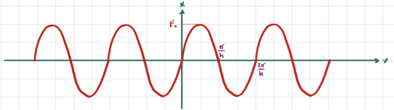

Consider the expression ##\vec{E}(y,t)=-E_0\sin{(-ky+kvt)}\hat{i}=E_0\sin{(ky-kvt)}##.
Consider a specific time ##t=0##. Then ##\vec{E}(y,0)=E_0\sin{(ky)}\hat{i}##.
This is a function of the coordinate in the ##\hat{j}## direction.
At each ##y## we have an electric field vector pointing somewhere along the ##x## axis, ie, a multiple of ##\hat{i}##.
At ##y=0##, for example, we have ##\vec{E}(0,0)=0##.
At ##y=\pi/2## we have ##\vec{E}(\pi/2,0)=E_0\hat{i}##.
Here is a plot
So, what we have for ##t=0## is an entire sine wave along the ##y##-axis.

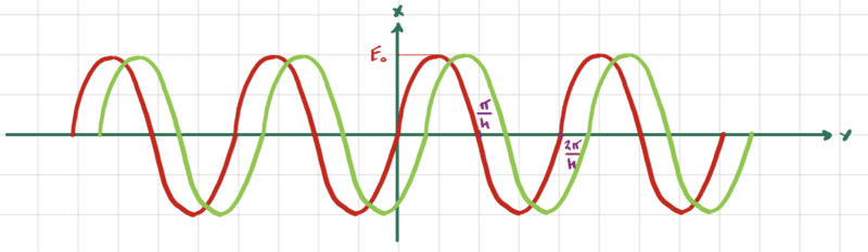

Now let's consider some other time ##t##.
Assume ##k>0##, ##v>0##.
Note that in ##\sin{(ky-kvt)}## the ##kvt## is just a constant and represents a negative phase angle, which means that we shift the plot seen above to the right (green plot below).
The wave, then, seems to be moving in the ##+\hat{j}## direction.
