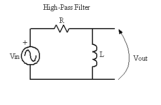

Hey guys, I've recently completed a module on circuit theory and I came across this particular slide on RL circuits (High Pass Filter) which puzzles me:
High Pass: RL Circuit, Low Pass: RC Circuit
The phase is given by:
tan ψ = (ωL/R)
but the very next line it is written as the reciprocal:
tan ψ = (R/ωL)
And the corresponding bode plots are based on the second (inverted) phase..

It looks like the first one is meant to represent the phase shift for the low pass filter (output across the resistor), while the second one is for the high pass filter (output across the inductor). Could have been better explained on the slide.
It doesn't look like it...as the first slide is talking only about the RL (High-Pass filter) circuit, and how the total voltage VT has a phase difference from the supplied current..
Then the second instance is simply incorrect.
Also note that Bode plots generally plot the phase of output voltage compared to the input voltage. That is, the angle of Vout/Vin. For a high pass RL filter, that would be the voltage across the inductor compared to the voltage across both.

Sure. All you need is mathematical "machinery" which incorporates magnitude and angle information just like phasors do. In other words: complex numbers. Combine resistance and reactance into a single entity called impedance (usually denoted "Z") and you can deal with AC circuit analysis using complex arithmetic in the same way you did DC resistor circuits with real arithmetic.
Inductive reactance gets an angle +j to denote the way voltage leads current by 90°. So ZL = jXL. For capacitors, current leads voltage so ZC = -jXC. Resistors, of course, remain real valued, ZR = R.
For the high-pass RL filter the output is taken across the inductor, so using the voltage division rule with impedance:
$$Vo = Vin \frac{j ω L}{R + j ω L}$$
then isolating output/input and simplifying to magnitude and angle:
$$\left|\frac{Vo}{Vin}\right| = \frac{ω L}{\sqrt{R^2 + (ω L)^2}} ~~~~~~~ \phi = tan^{-1}\left(\frac{R}{ω L}\right)$$
and there's the fodder for your magnitude vs frequency and angle versus frequency Bode plots.

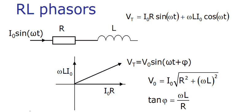

Yup I usually use complex impedances to work out the magnitude and angles. But I feel like I don't quite understand phasors (in trigonometry style)...
For example:
VT = V0 sin (ωt + ∅)
Represented in the phasor diagram:

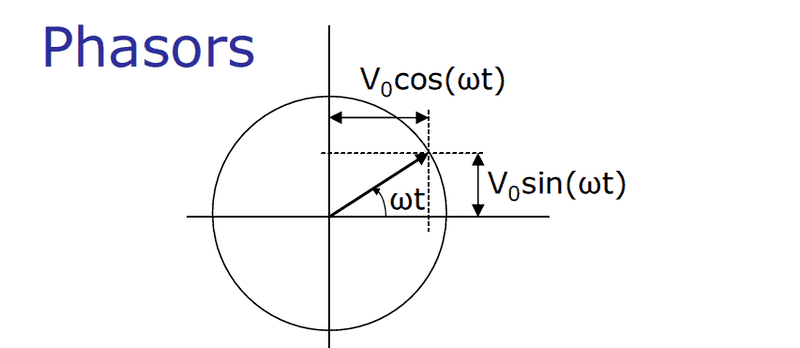

1) The direction of the current is defined along I0R right?
2) The p.d. across the resistor is given by VR = I0R sin (ωt). Does this mean that only the vertical component of I0R is taken at any point of time? (Like right now in the picture the vertical component is zero??)
3)Why did they simply put I0R instead of I0R sin (ωt) ? By omitting the sin (ωt) part, you are missing out the point that the angle of the vector I0R is increasnig with time..
4) Won't this imply that the phasor diagram (trigo-style) only takes "snapshots" of the phasor vectors and not a "video" since it doesn't describe its rotation..

Don't think of assigning a direction is space to the current; Rather, take it to be flowing in a certain "direction" with respect to the components in its path, engendering potential drops or rises accordingly along the way.
Phasor diagrams represent a snapshot of the relationships between currents and voltages in a circuit. Usually the x-axis is taken to coincide with the phasor of some convenient voltage or current taken as a reference 'direction'.
In complex fashion I'd write VR = I*R, where both I and VR are complex values. VR will have a magnitude and angle (it's a phasor) but you can recover the time domain function as ER = |VR|sin(ωt + ∅); Thus the ongoing "rotation" at rate ω is implicit, just as it is for phasor diagrams.
It's not missing, it's implicit in phasor diagrams (and the complex math version). It is part of the definition of phasors and how they relate to complex numbers, vectors, and exponentials, that the time dependent portion of each value is dropped in the notation since they remain constant throughout the calculations and are just 'baggage' to carry along through the algebra. What is key to doing circuit analysis with phasors is the magnitude and relative angle relationships between them. You can always recover the time domain expressions from the complex or phasor values.
Right. See above.

IoRsin(ωt) is a real-valued signal, what you'd measure if you could put a measuring device across it.
Io is a real constant giving the magnitude of the time-domain current. The impedance of a resistor is just R, a real value with no complex component, so the resistor doesn't do anything to alter the phase of the voltage across it w.r.t. the current.
In the phasor domain, if IoRsin(ωt) is used to provide the reference phase, then its phasor is just Io. The "sin(ωt)" becomes the implicit rotation/phase reference.
Now, if you were looking for the p.d. across the inductor with this (phasor) current Io flowing through it, then you'd have: ##V_L = I_o jωL##. That "j" tells you that the voltage you measure here will be 90° ahead of the current's phasor.
Using the same current as the reference but taking the total p.d. across the resistor+inductor you'd find: ##V_T = I_o (R + jωL)## . Now that's a p.d. with real and complex components. i.e., it has a phase with respect to the reference phasor, and in the time domain its voltage peaks are offset from the current's peaks. In fact,
##V(t) = V_m sin(ωt + \phi)## where:
##V_m = |V_T| = I_o\sqrt{R^2 + (ωL)^2}##
##\phi = tan^{-1}(ωL/R)##
Since phasors rotate implicitly, if we were to animate the diagram and allow it to rotate in real time, the "real" projection of a given phasor phasor onto the reference axis would vary in time just as you'd expect an AC signal to do. This "real" projection is what we'd measure at a given moment in time. But note that periodically the full length of a given phasor will coincide with the "real" axis. So we will measure the full magnitude of the phasor as the +/- limits of the given signal.

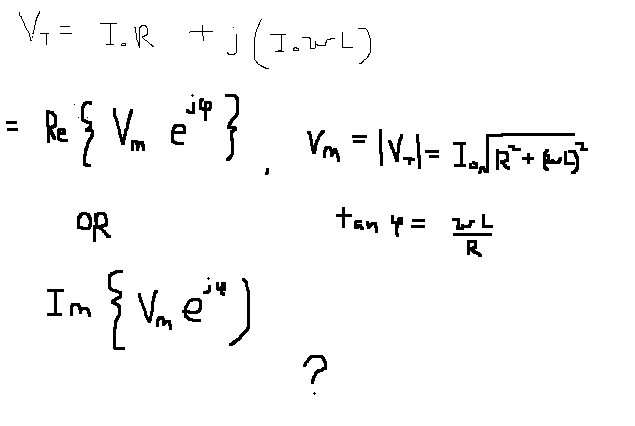

So, do for the total voltage and voltage across inductor, do we take the real part or imaginary part?
Um, for what purpose? Since for VT the driving current is the phase reference, time-domain versions of VT would be:
##V_T(t) = V_m cos(ω t + \phi)~~~~~~~## if the current is ## I(t) = I_o cos(ω t)##
##V_T(t) = V_m sin(ω t + \phi)~~~~~~~## if the current is ## I(t) = I_o sin(ω t)##
Keep in mind that phasors represent relative magnitudes and phases for related oscillating quantities; They aren't the signals themselves. When the phasors are imagined to rotate at rate ω, projection onto any fixed axis will yield the same relationships between the signals over time. It's a bit like looking at an indefinitely wide plot of all the signals and choosing an arbitrary starting point for t=0. Sliding the t=0 along alters the phase offset of all the signals by the same amount. You can find suitable starting points where the reference signal plot looks like a sine wave or a cosine wave, or anything in between.
For the RL circuit we've been looking at, the phasor for the voltage across the resistor lies in the same direction as that of the reference signal (here it's the current that's driving the circuit). The phasor for the inductor voltage is 90° offset from this reference direction. Adding the two yields the phasor for the total voltage ("apparent voltage"). It's a phasor with magnitude Vm. Now, if you stuck a meter across the circuit it would show an AC reading of magnitude Vm. Sticking the meter across the resistor would show an AC reading of magnitude IoR. Sticking a meter across the inductor would show an AC signal of magnitude IoωL (AC Voltmeters read the signal magnitude; they know nothing about phase).
You'll find that things get a bit more complicated when you start looking at the products of phasors rather than their addition. In particular, when you use phasors to find power. Then there's the concept of Real power and Reactive power and Apparent power... and some mathematical tricks are used to extract convenient relationships between them and average and RMS values of voltages, currents, and power. It would be best to consult a good textbook for that discussion...

So I suppose if you put a voltmeter across the entire circuit, when VT is expressed in complex notation:
to mathematically calculate/express the voltage you take the imaginary part of the function? (given it's sin (ωt + ∅))
No, the meter would read Vm, the magnitude of both the phasor and the complex number.
Suppose you have a voltage phasor E that's of length 10V and has a phase of 60° to the reference. The complex version would be E = 10V(cos(60°) + j sin(60°)), or E = (5 + 8.66j)V.
Consider the projection of this phasor on the reference axis. When the reference signal is at the start of its cycle our phasor E has a projection of length 5V on the reference axis. But ωt = 120 degrees later its projection will be the full -10V --- because phasors rotate they periodically project their full length along the reference axis.
Voltmeters have no way to distinguish relative phase. They just present the amplitude.

You can take ANY axis through a phasor diagram (it just represents an angular offset from the reference) and ALL phasors will cycle through their full lengths as projections along that axis.
A meter measures the amplitude of the projection of the phasor, over time, against what is essentially a randomly chosen axis. It presents to you a time averaged value of the magnitude of the signal it sees.
Yes, phasors have fixed angular relationships to one another. As such, various projections of one onto the other have fixed sizes. But a "real life meter user" sees the result of the "profile" of many rotations of any given phasor.
The above two are equivalent versions of the time-domain signal. With Im() you've "picked out" the component of the expansion of ##e^{j\theta}## which matches the sine function, since
$$Ae^{j \theta} = A(cos(\theta) + j sin(\theta))$$
No, every value of that function would be a complex number so it wouldn't match your real valued sin() version.

Since voltages across the circuit are "real values", do we simply take the real component? Or do we first examine the function whether it is a sin() or a cos() before taking the imaginary or real components respectively?
The problem is, you keep wanting to identify the "actual real-world measurable value" with one component of a phasor or the other. In general you can't. The real-world measurable value is the MAGNITUDE of the phasor. The phasor rotates and periodically (ω) presents ALL of its profile to any given axis. The meter sees an AC signal that oscillates between extrema which are the size of the phasor magnitude.
The purpose of the angle associated with the phasor, and the two separate components of its complex representation, is to keep track of the phase relationships between various quantities in the circuit.
Now, it may happen that you have a simple situation such as the RL circuit here where the phase difference between the voltages across the individual components is exactly 90 degrees. Then the total voltage across the two in series has a phasor representation which neatly places all the resistor's contribution in the real term and the inductor's in the imaginary term. That let's you select Re() or Im() of the phasor to pick out the individual voltages of those TWO components. It's a mathematical convenience here.
At this point you might want to think about what would happen if there were THREE components, such as another resistor in parallel with the inductor, or a capacitor added to the string. The components of the phasor for the total voltage aren't so easy to identify with individual components then.
mm. The 'phasor', in this case, seems to just be the (complex) total voltage. So the phasor diagram shows the complex total voltage on the complex plane, for some particular value of time. And if we watched the phasor diagram evolve with time, then it would simply show it rotating in a circle around the origin. So the axes of the phasor diagram do not necessarily represent the voltages across the circuit components.
