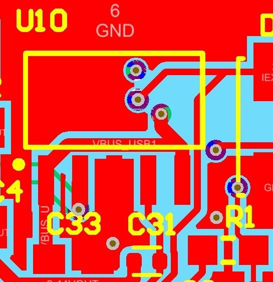

I see I need to verify the ground inside the unit. The Sensor unit is powered from a USB hub and it has a common ground with the Sensor internal circuitry. There is a long USB cable between the USB hub and the unit. I wonder what it does to the unit ground? The long USB cable, does it make the ground noisier or less effective?
Thank you.

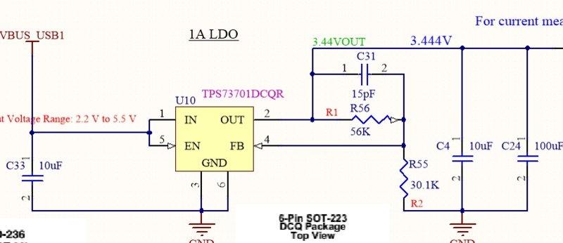

What is the dropout voltage of the LDO? Does it have any specs for input-output noise rejection over frequency?

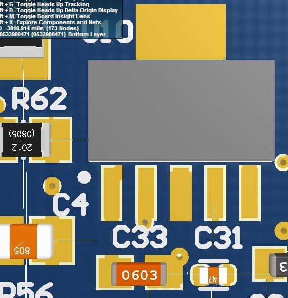

Can you share the schematic for this board? Can you share the layout?
If you have a working prototype, I'd try to shunt off the noise with capacitors as close as possible to the connector (on the input side of the LDO). Try to minimize the mounting inductance, but even a less-than-perfect implementation should give you instant hope if there is any. You already have plenty inductance in the cable which will act as the L in your LC filter, so I'd worry about adding bulky inductors later.
Thank you, I agree about the cable. I do have a 10uF cap 15-20 mil from the part, almost on the part. Should I make it larger?

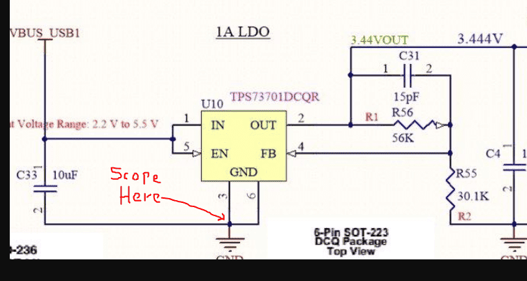

Switching power supplies are electrically noisy.
Make sure you're not seeing stray pickup on your scope
by connecting both the 'scope probe and its little ground clip to same signal common point on your gizmo
If it's quiet, ie no noise, then you have capability of decent 'scope measurements.
If it's quiet then move scope probe to +5 line but leave the ground clip on common.
C33 is probably electrolytic and will need to be bypassed by a small high frequency capacitor.

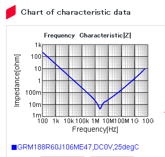

C33 is a ceramic cap (GRM188R60J106ME47D) . I will try to place my scope the way you recommend. C33 is very close to the LDO. C33 goes straight into the ground via a VIA connection.
chakr said:
[...] C33 is a ceramic cap (GRM188R60J106ME47D) [...]
This makes me less optimistic about my initial thoughts about adding low-inductance capacitance right at the input of the connector, as the sole solution. I'd still attack the noise on VBUS close to the connector, but perhaps a (bulky) series inductor will ultimately be necessary in addition to the cap. The cap-only solution is very easy/cheap to try, which is why I suggested that first. Does it have any effect at all? Also note that the effective capacitance of GRM188R60J106ME47D [1] is 3uF with a 5V DC bias, and not 10uF as you maybe think it is. The little snippet of your PCB layout does not reveal enough to be helpful. In fact, there's a lot to be said about layout here, for all we know you've split your ground plane in some ludicrous way etc etc--small things that alone could kill your design.
Did you explore the noise rejection ratio of your LDO as berkeman suggested?
[1] https://psearch.en.murata.com/capacitor/product/GRM188R60J106ME47#.html

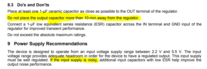

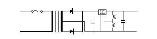

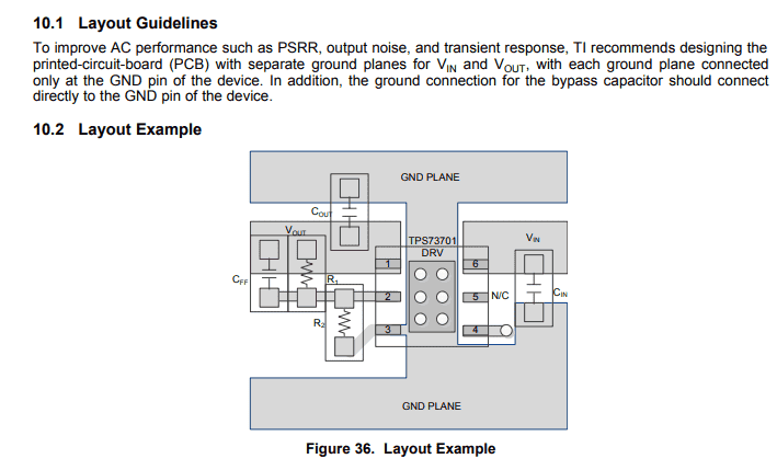

just fishing...
from TI datasheet
to your question about an inductor
even a ferrite bead would help.
Dont obsess about its stray capacitance, your 10μf should swamp it. I'd worry more about Z of that single via..
Scope check might reveal something.
old jim

First thing though is to see if 'grounding' scope probe at the circuit common cleans up the trace.
If it does you've probably been picking up radiated noise through the air and might call that 'measurement error' ..

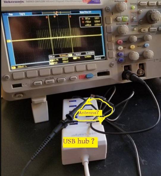

Hi, I tried to add a capacitor to the USB connector. Unfortunately, it didn't help. The ground areas on the top layer are broken because I have components. Internal layers have continuous ground planes, but I do not have a dedicated ground layer. Maybe that is the problem? My choice of the input decoupling cap seems to be wrong.
Thank you for your advice. Noise is fun to deal with.
Rive said:
How is that hub powered? Can you attach your sensor to a PC for a short test? Are you sure you don't have a ground loop somewhere (maybe through your oscilloscope)?
Ps.: How does the power looks like on the input side of the hub? How does it looks like on the output side without your device?

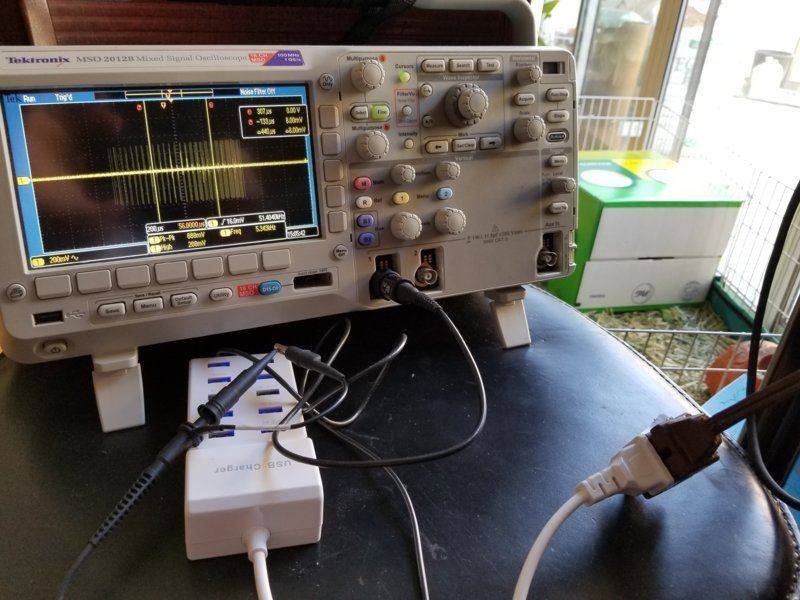

Hi Rive, the hub is powered from straight AC. I have attached an image from my scope that shows the noise. The scope shows noise from the hub even when it is not connected to my device.
Ugh. I think what you are trying to repair here is not your circuit but your equipment. Please try to power it from a different source (for example, from the computer you are using to access this forum).
