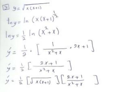

Hi ..
Use logarithmic differentiation to find the derivative
can please check my answer and How I can know if the question want answer by using logarithmic differentiation or not ?

In your 4th line you have a mistake.
Your 3rd line is:
ln y = (1/2) ln(x2 + x)
When you differentiate the left side, you should get (1/y) y', due to the chain rule.
In your last line a factor of y seems to have magically popped up on the right side. You got the right value for the derivative, but several steps in between are incorrect.

Answer is correct, but as Mark pointed out there are some errors along the way.
It could be simplified. You have [itex]\ \sqrt{x^2+x}\[/itex] in the numerator and x2 + x in the denominator.
If you have x in an exponent and also have x in the base, then logarithmic differentiation can be helpful.
The function you are differentiating here can be done more easily by simply applying the chain rule.
You usually use logarithmic differentiation when the exponent is also a variable.

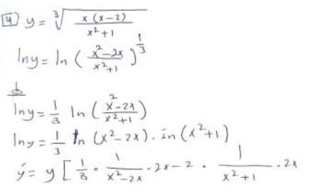

thanks so much ...
can check this answer please
You really should start a new thread for this.
The 1/3 multiplies both logarithms .
