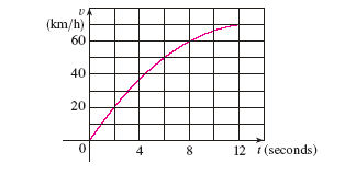

Use the midpoint rule to estimate the average velocity of the car during the first 12 seconds.
Click here to see the graph from my book.
i understand the midpoint rule is
$$\frac{b - a}{n}$$
so $$\frac{12}{4} = 3$$
so $$n = 3$$
I also know that
$$\frac{1}{12} \int^{12}_{0} v(t)dt $$
But now I'm stuck... any guidance anyone can offer would be great.
The average velocity would be given by (as you stated):
$$\overline{v}(t)=\frac{1}{12}\int_0^{12}v(t)\,dt$$
Using the Midpoint rule to approximate the integral in this expression, with 3 sub-intervals of equal width ($n=3$), we could state:
$$\int_0^{12}v(t)\,dt\approx\frac{12-0}{3}\sum_{k=1}^3\left(v\left(2(2k-1) \right) \right)=4\left(v(2)+v(6)+v(10) \right)$$
Do you see that we evaluate the velocity function at the midpoint of each sub-interval?
Now you just need to read the needed values from the given graph.
