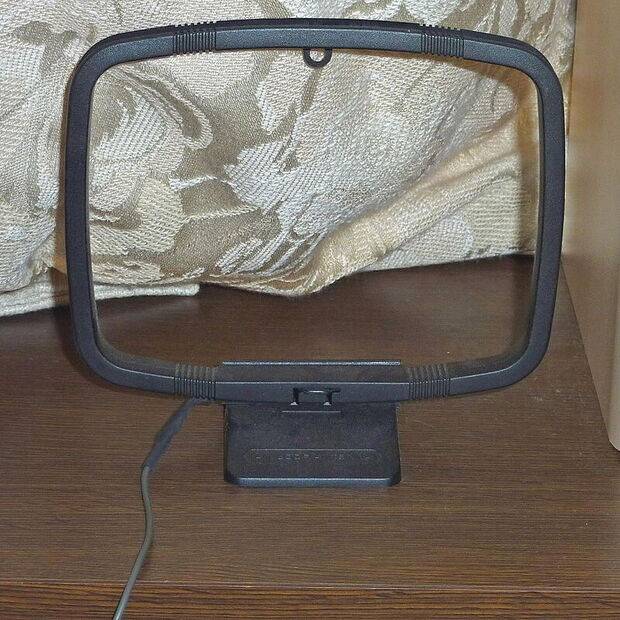

You can buy AM loop antennas like this, but you probably need more turns for lower frequency.

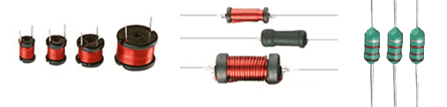

I have already experimented with multiple different chokes. The "thinner" ones had below measurable results, so the thicker is better.
I have had quite promising results using two serially connected radial inductors of 220uH, a slightly bigger model similar to this:
https://www.tme.eu/Document/2792acb9c9f7927cee8a03f26264361b/07HVP 07HVP_T.pdf
For the next experiments I'm putting my bets on these axial models:
https://www.tme.eu/Document/6b3e2e8e19992b82af7cd5bc8aec3083/VHBCC.pdf
https://www.tme.eu/Document/a0e02d9fef82b840a7832199fb404428/77A.pdf
The configurations I will be testing are 2x 100uH / 1000pF and 2x 1000uH / 100pF (356kHz resonance).

You need to select a core that maximises the sectional area of core inside the windings. That intercepts most B field from space. PCB chokes are designed to minimise stray fields, which makes them bad receive antennas. Because they have very low stray fields, toroidal cores are used for high current chokes and make really bad antennas. The PCB mount chokes you are using are designed for small signal, not power, so they have high resistance. You have made a rod for your own back by selecting a PCB mount choke as your antenna.
