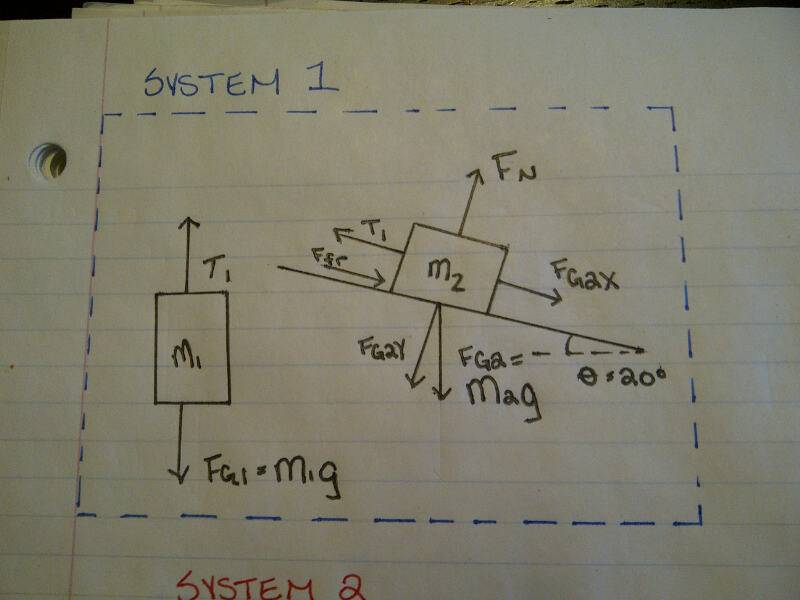

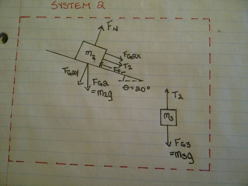

I have a problem involving a system with an incline and three masses. A picture of the system is in the attachment labeled 15.1. I am to calculate the tension in each string and the acceleration of the system.
I have an idea for solving this problem and would like to know if I'm on the correct track. I divided the system up into two individual systems seen in attachments 15.2 and 15.3. My reasoning is that I should be able to calculate the first string tension (T1) in system one and then calculate the second string tension (T2) in system two. I would then use the difference between T1 and T2 to derive a net force on the entire system. With a net force I could then calculate the acceleration of the system as a whole.

Your approach may well work, but I'd be inclined to draw 3 FBDs (one for each mass), and solve the resulting equations simultaneously.
What's the coefficient of friction between mass 2 and the inclined surface?
I believe that you'll have difficulty finding the individual tensions by your method, since those tensions are going to depend upon the net acceleration of the system which, in turn, depends upon all three masses.

I'm sorry, I made an error with attachment 15.3 as I forgot to add the force vector T1 to my diagram. I've corrected it in attachment 15.4. Attachment 15.5 shows how I've designated the masses and the two string tensions.

Nope. Doesn't work. You're system 1 goes off the rails when you write:
T1 - Ffr - Fg2x = m2a
This equation cannot be true since it does not include the effect of T2 on the acceleration of m2. As a result your value for T1 is incorrect. That error propagates through the subsequent calculations.
With this attempt, I've determined a new equation for m2 which accounts for both T1 and T2 and have incorporated all three masses into determining an acceleration for the entire system.
