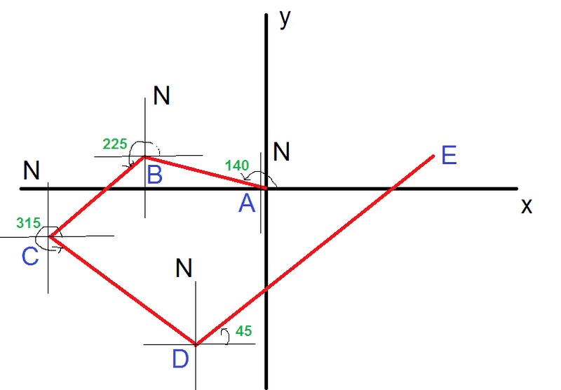

Ok, it's clear about that. But now I'm trying to do more advanced calculations. I want to include heading and distance in my calculations. Let's say I integrate resulting acceleration vector twice to get distace.
resulting_acc = sqrt(accX^2 + acc_Y^2)
To get heading, I use magnetometer data, so direction = atan2(Mag_Y,Mag_X), then I convert it to 0-360 degrees.
Where exactly this heading angle is on the plane?
Is this angle to north like in the picture?
