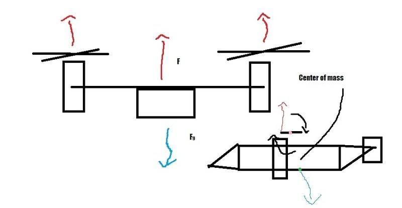

Seatbelt fastening, that makes sense but what about changing payload distributance(changing center of mass), unless the center of mass is exactly under the axis of the rotors, the force from the rotors should theoretically create torque with the gravitational force, creating spin(pitch) that would make the plain crash,
Now unless the crewmembers form with the plane a center off mass intersecting the axis of the rotors, the plain should theoretically crash every time.
I made a spotty picture but I think you should get my point, without stabilization, torque is created
somehow they managed to avoid this, maybe there is torque but too insignificant to create any substantial pitch.
In the picture the center of mass is a bit behind the rotors, this can be imagined as a fat passenger sitting in the back.
The center of mass is below the position of the rotors. This makes any helicopter stable to a certain extent when hovering, because the body acts like a pendulum hanging the rotor(s).
Of course if you move the CM horizontally, the plane will "tilt" a small amount and tend to start flying horizontally in some direction instead of hovering above a fixed point on the ground. But making small corrections for that is no worse than compensating for effects of variable wind speed and direction.

Like with a helicopter, the individual blades of the rotors can pitch about their long-axis.
Electronics use sensor information from accelerometers and navigation to control this in relation to the intended actions of the pilot and to adjust for movement in the center of mass.
This gives a lot of control both during take-off and landing, and during transition to forwards flight.
