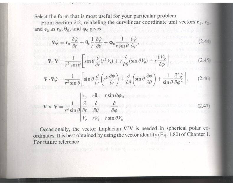

If we define Laplacian of scalar field in some curvilinear coordinates ## \Delta U## could we then just say what ##\Delta## is in that orthogonal coordinates and then act with the same operator on the vector field ## \Delta \vec{A}##?

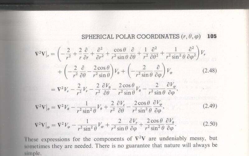

See Arfken on this. For example, in spherical polar coordinates here is the Laplacian acting on a scalar field (first scan) and components, with respect to spherical polar coordinate unit vectors, of the Laplacian acting on a vector field (second scan). Arfken says on the vector Laplacian that "It is best obtained by using the vector identity (Eq. 1.80)". This vector identity is
\nabla \times (\nabla \times \vec{V}) = \nabla \nabla \cdot \vec{V} - \nabla \cdot \nabla \vec{V} .
  • Textbook page showing spherical polar coordinate formulas: gradient of a scalar, divergence of a vector, Laplacian of a scalar, and curl of a vector, numbered equations 2.44 to 2.47.
  • Printed page 105 of a textbook titled Spherical Polar Coordinates (r, θ, φ), showing equations 2.48 to 2.50 for the components of the vector Laplacian V²V in spherical coordinates, with a short paragraph below calling these expressions messy.
I must also disagree with Arfken here. That involves taking the curl twice, gradient once, and divergence once, which is a mouthful. Better would be to learn about the covariant derivative or use knowledge about how basis vectors in curvilinear coordinates are affected by derivatives.
