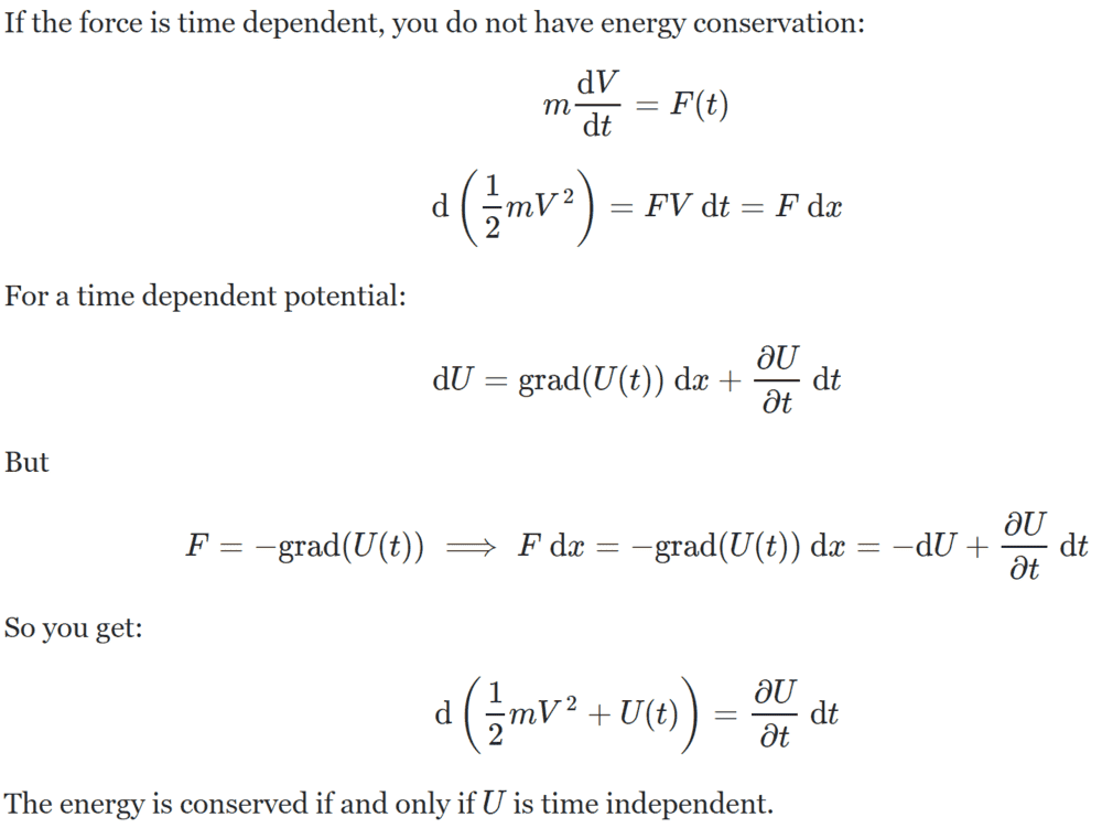

Thank you again.
  • You are right, a static magnetic field generated by electric currents (i.e. by an electromagnet) and a time-dependent B field are NOT conservative (only a static B field generated by permanent magnet is conservative).
  • As far as the conservation of energy and time-dependent fields, a generic force vector field ##F(t)## cannot be conservative (i.e. cannot keep mechanical energy constant) because it would be the negative gradient of a time-dependent scalar potential ##U(t)##: $$ F(t) = - \nabla U(t)$$ and the derivation below shows how the total mechanical energy ##ME = KE + U## would stay constant only if ##U##, hence the vector field ##F##, is not time-dependent.
Thanks, nice derivation which I was eluding. It shows (in my opinion) that the notion of conservative in mathematics(defined as a vector field being conservative when it is equal to the gradient of a scalar field or equivalently the curl of the vector field being zero) does not necessarily coincides with the notion of conservative in physics (defined as a force vector field that conserves mechanical energy) . The force field ##\vec{F}=-\nabla U(x,t)## in this derivation has curl zero for any time instant t however it does not necessarily conserves mechanical energy.
