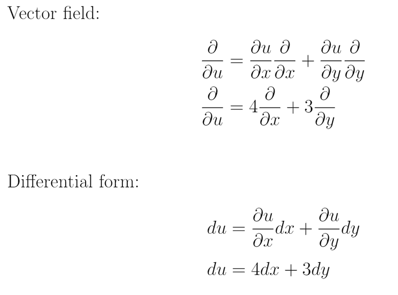

We have xy-plane, which is has a mapping (x,y). Another map is (u,v) and the transformation of coordinates are u=4x+3y and v=x+y.
1. Write vector field \frac{\partial}{\partial u} in the map (x,y)
2. Write the 1-form du in the map (x,y)
u=4x+3y and v=x+y.
Here is a picture of the solution I made :
Typeset math comparing a vector field and a differential form: under 'Vector field', ∂/∂u = (∂u/∂x)(∂/∂x) + (∂u/∂y)(∂/∂y) and ∂/∂u = 4∂/∂x + 3∂/∂y; under 'Differential form', du = (∂u/∂x)dx + (∂u/∂y)dy and du = 4dx + 3dy.
So my question is: Are these right and how do they differ from each other?
In a formal Mathematical sense, they're duals to each other. Differential forms are evaluated at Vector Fields to produce numbers.
## \text { The first thing: } ##
## \frac { \partial } { \partial u } \text { is not a vector field. } ##
## \text { The second thing: } ##
## \text { The expression } \frac { \partial } { \partial u } = \frac { \partial u } { \partial x } \frac { \partial } { \partial x } + \frac { \partial u } { \partial y } \frac { \partial } { \partial y } \text { is not a correct expression. } ##
## \text { It should be } \frac { \partial } { \partial u } = \frac { \partial x } { \partial u } \frac { \partial } { \partial x } + \frac { \partial y } { \partial u } \frac { \partial } { \partial y } \text { where } x \text { and } y \text { are functions of } u \text { and } v \text { . } ##
