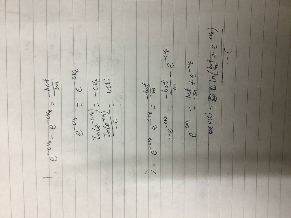

MichaelTam said:
So, using the post equation in 19, I got 2, but using the 25post ,I get 1.
I have no idea how you keep getting ##e^{-c v_0} = e^{-c v_t}##. Where does that come from?
What I wrote in post #21 was, suppose we allow a constant of integration, k:
##e^{-c v_0} - e^{-c v_t}=\frac {-b c t} m+k##
If we evaluate that at t=0 we get:
##e^{-c v_0} - e^{-c v_0}=0+k##
Look carefully at the left hand side. Everything cancels there, leaving zero, so k=0.

Your problem is that you do not understand the difference between a definite integral and an indefinite integral.
1. Definite integral
$$\int_{x_0}^x u~du=\frac{1}{2} \left. u^2 \right |_{x_0}^x=\frac{1}{2}x^2-\frac{1}{2}x_0^2.$$You just evaluate the antiderivative at the upper and lower limits and subtract the latter from the former.
2. Indefinite integral
$$\int u~du=\frac{1}{2} u^2 +k.$$There are no upper and lower limits; constant ##k## is a placeholder for the lower limit. In this particular problem you have a definite integral, you know the lower limit, therefore the placeholder is not needed or, as has already been shown, it must be zero.

So, is my answer in the equation two is the simplest answer?
Why my answer in the equation 2 is still incorrect?
  • #34
Ops, I find my self have some typing error, the answer in the equation two is correct, thank you kuruman and haruspex!

I got v(t) = -1/c ln( e^(-c v_0) + bc/m t ).
  • #38
Good.
