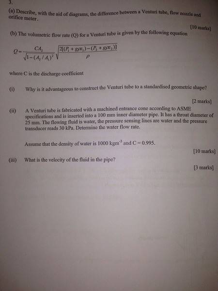

Hey guys. I can't figure out part 3bii) of this Venturi Tube Question.
The answer I keep getting is 3.7907E-03 but it should be 3.95E-03. I'm definitely missing something but can't figure out what. I'm out by about 5%, could it just be down to rounding errors?
Question and my working is shown in the attached pictures.
Question:
Attempted Answer:
Would really appreciate any help. Thanks!
What units are you using? Your calculations are not complete unless you indicate your units.
