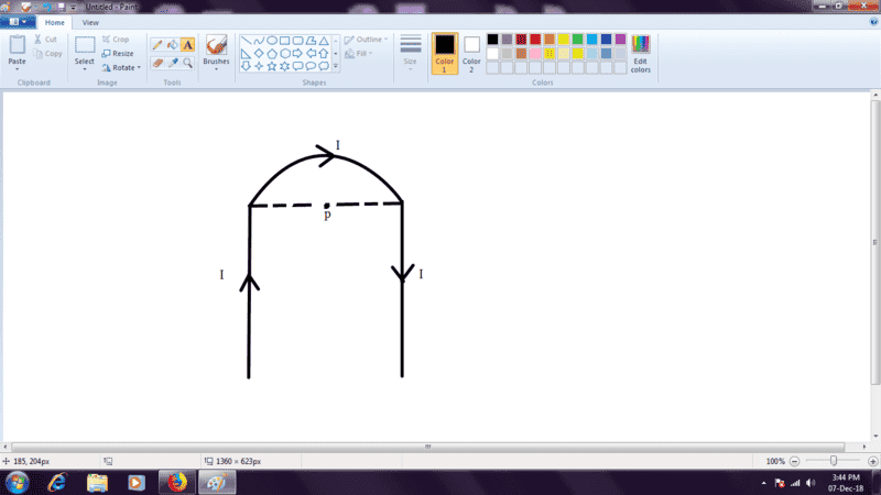

Yes, I know that it is quite misleading. For example, we are required to find the "magnetic induction" at point P:
(radius and lengths are given)
I was completely blank at this problem. Later, when I looked at the solution, it just showed we have to find the net magnetic field at point P. From then on, I developed the notion that magnetic field strength and magnetic induction are same!
