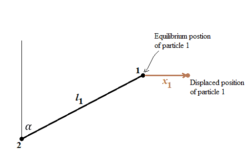

Consider arbitrary vertical displacements of the atoms as shown in the attached figure. Please show us your attempt at expressing the angle δ in terms of y1, y2, y3, S12, and S23.
EDIT: I was assuming your question has to do with the expression given by LL for δ. If not, are you asking why they take the potential energy to be of the form (1/2)k2l2δ2?

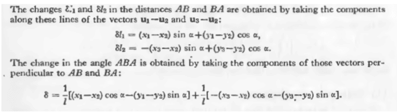

I appreciate your insight. If you have the patience and time, I was wondering if you knew how they use 24.2 to obtain the expression in Problem 2:
(y_1-y_3)\sin{\alpha}-(x_1+x_3)\cos{\alpha}=0
I'm a bit confused about the displacement vectors u_1 and u_2 they are using.
Sorry for all the questions but this is my first real mechanics course (my university doesn't have a second or first year course) and my professor is literally copying his notes from LL without going into any detail of what anything means, so I'm basically following this book by myself in my spare time.
In applying 24.2, note that ##\vec{r}_{10} = l\sin\alpha\hat{i} + l\cos\alpha\hat{j}## and ##\vec{u}_{10} = x_1\hat{i} + y_1\hat{j}##, etc.

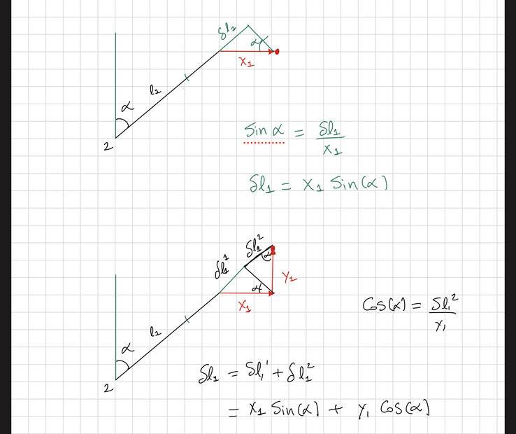

Hello, TSny. I realize it has been a long time since this publication, but perhaps you can assist me in understanding something related to the same 24.2 exercise (Page 73, triangle molecule, Landau-Lifshitz). Specifically:
I'm not sure how these three conditions came about.
I'm fairly sure that a good number of my brain cells that were working way back then are now kaput. :oldsmile:
But, let's start with how to get $$\delta l_1 = (x_1 - x_2) \sin \alpha - (y_1 - y_2)\cos \alpha.$$ Consider the case where only particle 1 is displaced in the horizontal direction from its equilibrium position by the amount ##x_1## as shown:
Can you derive an expression for the change in length, ##\delta l_1##, of ##l_1## in terms of ##x_1## and ##\alpha##.
Then consider how ##l_1## would change for a vertical displacement ##y_1## of particle 1.
How would horizontal and vertical displacements ##x_2## and ##y_2## of particle 2 change ##l_1##?
Thank you for answering to my question. Using your illustration, I found the following, but I don't see how a displacement of point two can influence it. Since the angle alpha would changing if the point 2 is displaced
If you keep particle 1 fixed and displace particle 2 horizontally by ##x_2##, then you can see that ##\delta l_1 = -x_2 \sin \alpha##, etc.
But, you are right to worry about whether we can treat the individual displacements ##x_1##, ##y_1##, ##x_2##, and ##y_2## as acting independently in changing ##l_1##. We can as long as the displacements are "small" compared to ##l_1## and we only want expressions accurate to first order in the displacements.
