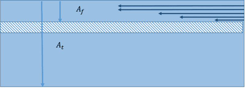

Perhaps if I rephrase my question I can simplify what I am ultimately trying to understand - In the presence of a surface, impermeable to any component of ux, (Represented in my diagram by the angled surface of my membrane )
  • will the static fluid area beyond this impermeable surface be available to carry this momentum according to Bernoulli's
  • will flow through this surface be only dependent on an overall Total pressure gradient ?

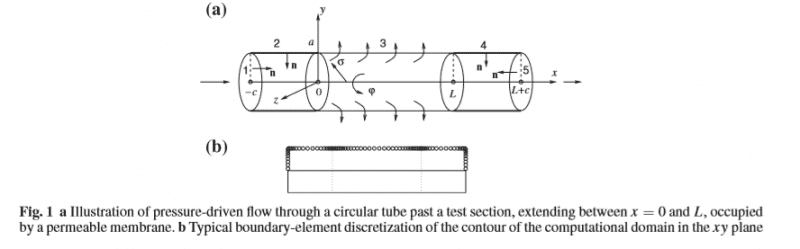

Explanation from suggested readings
I have read what I can of this article and while i understand there is a 'through' radial velocity -I am still confused about how the no slip condition, zero parallel velocity =0 ( axial =0 ) is broken, from the article -
'At the tube surface inside the test section, we require zero axial velocity, ux=0, and a radial velocity given by Starling’s equation uσ =Lp (p− pa)

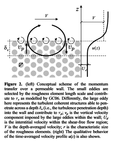

I have found another article of Interest (albeit on turbulent flows) http://onlinelibrary.wiley.com/doi/10.1029/2012GL052369/pdf which outlines the effect of vorticity and momentum penetration on increasing the friction coefficient and depth where ux=0 becomes zero but it still suggests that ux still applies within the boundary. From this article I see a similar Starling term ud that would be driven from a total pressure difference

I'm having a harder time understanding your question now. The no-slip condition means that fluid in contact with a solid *must* have the same velocity as the solid, in order to avoid a singularity in the stress tensor. However, for a permeable surface, the fluid velocity is not that of the wall- there is a component of velocity normal to the permeable surface, as fluid flows through the membrane, and that velocity is typically given as Starling's equation which involves the permeability of the wall and pressure drop across the wall.
