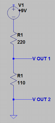

Hello all.
I wonder if anybody could clear this up for a beginner.
In the circuit attached: Is V OUT 1 of a higher voltage than V OUT 2?
Does the current travel at 9V, until it drops at R1? Does it drop again at R2 and give an even lower voltage to V OUT 2? Or does the presence of two resistors apply the total resistance to the entire circuit, giving both V OUTs equally lowered voltage?
Any help would be much appreciated. Thanks.
The voltage drops across every resistor.
The current remains the same through every circuit element.
So:
9V > Vout1 > Vout2 > 0

Vout2 = 0V. i don't like the voltage source symbol. i can't tell if Vout1 is -3V or +3V.

Aaaack, how did I miss this? There's no "circuit" here, no path for current to return to the voltage source.
So it's zero current through the resistors. Then all voltages are zero except at the +terminal of the source which is at +9V.
In principle, you'd want to connect the voltage source back to ground somehow.

The symbols are perhaps slightly deceptive. The triangle at the bottom represents the ground. The Voltage source is meant to be a source of positive voltage - must be conventional flow. It's an unusual shape for a "circuit" but irrelevant to my question.
Which was whether each V OUT receives equal (0) voltage or if 1 receives more (1/3) than 2 (0).

Meaningless circuit because there is no circuit so no current flow and no volt drop so as it stands V1 = V2 = -9 v wrt the +ve of the source.
Does the arrow down mean 'earth' or 'ground'. It si not the right symbol. A arrow like that usually means that circuit connects with another.

Say there is a circuit.
9V BATTERY NEG TERMINAL---R1(220)---LED1---R2(110)---LED2---POSITIVE TERMINAL​
In such a situation, where the total resistance leaves 0 voltage, will neither LED shine, or will one shine dimly while the other doesn't at all?
That's the best way in which I can ask this question. If that still doesn't make sense, I clearly understand too little and need to experiment some.

I've used LTspice myself, but don't have it installed yet on this computer that I started using a month or 2 ago. Keep playing around with the program and the circuit, you'll learn the more you do it.
To make this circuit "meaningful" you'll need to connect the battery + back to ground. From what I remember, you click on the icon that looks like a line or wire along the top row of the LTspice window. Then you can draw the wire to make the connection. Hit <esc> (I think) to stop drawing the wire.
Since the elements are all in series, and it's one big loop, both LED's shine equally (assuming they are identical to each other). Also, you could combine the two resistors into a single 330 ohms.
