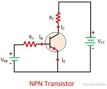

I do have a problem understanding transistor.
I know how these solve and work :
I know some basics like the voltage on Rb is Vbb - 0,7V. Or something like this.
I also Know that the maximal current in this transistor is "defined" by the resistor in the collector which is RC. So Vcc/Rc = Ic_max.
Those are my basics I understand so far, so increasing current Ib increases the current Ic and the voltage Vce is dropping to the point where is it equal 0,2V or 0,1V (saturation).
So everything is defined here by resistors. Okey I understand it.

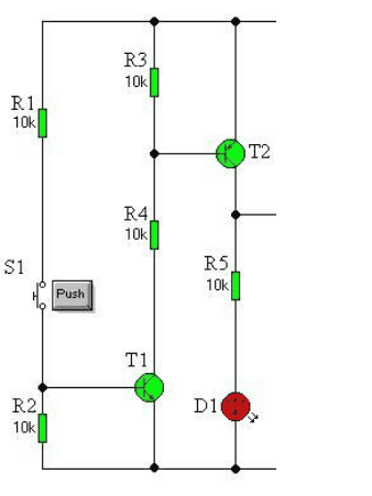

But then I tried to understand more "complex" circuits for example this one :
So I thought that : if it wasn't voltage divider but normal voltage source then Vb is equal the voltage source for example it is 5V so the voltage on RE should be 5V - 0,7V = 4,3V I get it. But then I tried with voltage divider let's say R1 and R2 are equal (10k) and the Vcc = 10V so the voltage on R2 should be 5V right ? So Vb = 5V. But when I connected the transistor then Vb changes to different value changes in the R2 ... Dunno why I used the basic principles of the transistor. I've heard that it acts like a load or a diode but I don't get it ...
Then I've heard that Ve can change as well as Vb ... so changing the value of resistor not only changes the Ve but also the Vb ...

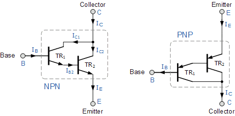

Or here :
How is it possible that connecting transistors with each other works ?
How is the current even defined there ? I know from the first picture (basics) that voltage and current in transistors are defined by the resistors. Okey you can say that I can connect resistors in the C or E or B point like in the picture, but the emiter of Tr1 doesn't have a typical connection like in the basics. Basics covered that resistors defined everything now I have in the emiter of Tr1 the base of Tr2. How does it work ? When I will reach the max current value ? How does the voltage change in Vce_1 or Vce_2 if there is this uncommon for me connection in emiter of Tr1 connected to base of Tr2.

Okey maybe something like this :
Here I can say that the voltage on the Rb is Vbb - 0,7V. So that Vb = 0,7V and Ve = 0V. Okey. Increasing the voltage won't increase the Vb nor Ve instead it will increase the current Ib. increasing Ib increases Ic. Increasing Ic will increase the voltage drop on Rc thus it will decrease the Vc. If we increase enough then the voltage will drop to Vce = 0,2 V which means it is in saturation.
Okey so there is something that limits it and has a direct impact on the single transistor.
Here :
I have Re and voltage divider, there is no Rb like before.
Instead of that the current goes directly to this transistor without any limits like before.
So what happens here ? Why does the Vb changes whenever I change a voltage or a resistor ?
How to predict the changes or how to predict in which state it is right now ? is it on active, saturation or cutoff ?

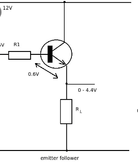

You were analysing an emitter follower at the time of the quote, not a voltage divider biased voltage amplifier.
Analyse the emitter follower with an emitter resistor only.
Sweep the base voltage from zero to Vcollector.
Then do the same for a Darlington pair.

You mean emitter followe like this ?
This one was quite interesting to analize.
Because before here :
The Vb was constant which was 0,7V.
Now in the first picture Vb can be anything just like Ve can be anything.
So hmmm how it works. Increasing Voltage in base will increase Vb ? Or maybe not ? Because the Ve also changes, the most important part is that Vbe is there.
Looking at this for example :
Well The Vb will be constant which can have any value but Ve will be equal Ve = Vb - 0,7V. So if Vb was equal 5V then Ve equals 4,3V. But adding Rb makes it different ? Increasing Vin when there is Rb doesn't tell me a lot about what will be the Vb. Will it increase or not ?
Also you have mentioned to do the same with Darlington. But how exactly ? Here there are resistors that defines most of the part, in darlington the connection emiter T1 - Base T2 the current is mostly unknown.
A BJT is a current operated device, with a current gain ratio.
You must become the BJT; and then think about currents.
You have been brought to your knees by your fascination and worship of silicon and 0.7 volts. VBE is not 0.7 V.
VBE is proportional to Log( emitter current ).
First, understand the currents in the BJT.
The resistors will be part of the external circuit.

Basically Transistor is about current which I understand because in active Ic = Ib*B (I don't know how to make beta to it will be a big B :D)
But usually how do I know what is the current that is provided to the base ? or to the collector ?
I have to use resistors.

I do know Kirchoff's Laws, Norton/Thevenin equivelants, Ohm Laws.
It's just that transistor behavies differently and wierdly for me. I can't predict anything what happens here :D

When I look at the picture I am sending in this post I just get confused :D So many factor to look at, voltage on T2 current in T2 what is limiting the IB (because there is no Rb).
In other words my mindset is stuck in the first circuit from the picture in Post#1. That Rb controlls the current but in other circuits it is different. I can't understand them from the pictures of transistors tutorials.

Here I have made a analize for picture nr 1.
In which I have analized everything. Vc, Vb, Ve, Ib and Ic.
I know why Ib has a specific value as well as Vb and other stuff here.
For emiter resistor it was a bit harder because Vb and Ve changes whenever I change something which is unpredictable for me. Of course I'm not using exact numbers, I'm trying to understand the intuition how enerything works.
I've tried with emiter like here in the Post#13.
But It was harder to understand how it exactly works.
So what should I look at. The current Ib, Ic or the voltage Vb,Vc and Ve ?
What makes the transistor works for Darlington or for divider if there is no Rb that can define the Ib.

Averagesupernova said:
@Xenon02 the schematic in post #24 is a very simple one. Based on what you say you grasp you should be able understand it. Please keep your posts shorter. Starting at the push button switch, what are you having trouble with?
Well in the schematic from post#24 the problem basically is that there are 2 transistor connected to each other + there is a voltage divider. I only know what I analized in Post#10 and Post#13 but with 13 it was a bit problematic.
first of all I don't know what is the current or rather what is limiting the current that flows from PNP which is T2, There is no Rb like in the Post#1 picture 1. Also this is voltage divider so calculating the Vb and Ve (here is actually 0V for Ve). But still the voltage divider + transitor just changes the Vb so if I calculated the voltage divider that has a specific value and it changes then the whole circuit behavior also changes.
Basically I don't get it why everything here works and how do they work (active,saturation,cutoff which one and why?) Or if I had a potentiometer or AC supply I cannot predict what is going to happen. For the post#1 picture 1 I could predict it even if I had potentiometer or AC supply connected to it because everything works like in the analizys.
So do you get confused if you draw in a resistor from base to emitter in the second schematic in post #13? Think carefully here.

Xenon02 - you are asking so many questions...it is not easy to give a comprehensive answer.
Perhaps the following list of steps may help. Here I have described how I would design a simple gain stage as shown in your 1st post (second circuit, figure 2):Step 1: Based on (a) the available supply voltage Vcc and (b) the required/wanted voltage gain Av you must select a collector resistor Rc and a DC quiescent current Ic. In this context, the following formula is essential
Av= - gmRc (with transconductance gm=Ic/Vt).
(Comment: The transconductance gm desribes the slope of the voltage control function Ic=f(Vbe))
Step2: Use an emitter resistor Re with a value of app. 10% of the Rc value (rule of thumb).
The DC voltage drop on (Rc+Re) should be app. 50% of the available DC supply Vcc.
From this we can derive an expresssion which gives a good „feeling“ for the maximum possible voltage gain (ignoring Re as a first guess):
Av= - gmRc= - (Ic/Vt)(Vcc/2)/Ic= - Vcc/2Vt (with app. 2Vt=50mV)
A gain reduction is always posible using signal feedback (step 5).
Step 3: Using the known DC voltage Ve at the emitter and with Vbe=0.7 V the required base voltage is Vb=Ve+0.7V.
This DC bias voltage should be created with a simple voltage divider (R1, R2) at the base. You are free to select the resistive niveau of this divider chain but there are some constraints (step 4) .
Step 4: The total input resistance should not be too small (with respect to the properties of the driving signal source) - on the other hand, the resistors should allow a DC current through the chain that is remarkably larger than the expected base current Ib=Ic/B (which goes through the upper resistor R1). It is the goal of this „trade-off“ to enable a „stiff“ base voltage Vb (which does not remarkably depend on the very large tolerances of B - another indication for voltage-control).
As a rule of thumb: Current through R1 is app 10*Ib.
Step 5: The emitter resistor Re (or a part of it) can be bypassed with a capacitor Ce. This is because Re does not provide DC feedback only - at the same time it provides also signal feedback which reduces the gain according to the expression:
Av= -gmRc/(1+gmRe).
When such a gain reduction is not desired the influence of Re on signal properties is eliminated with a capacitor Ce.
Final comment: As you can see, there is not only a simple set of formulas which can/must be used for designing such a gain stage. You still have some freedom during this design phase. This is very important because this gives you the chance to adapt the circuit to some application-specific requirements.
