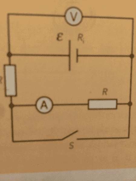

What happens with the voltmeter if we close s? How am I supposed to think here? I am guessing that the total resistace is oing to decrease and then what? btw is the voltmeter measuring emk or the voltage in the circuit?

How does the voltmeter reading change with the amount of current supplied by the battery (what influences the voltage reading)? Consider that the voltmeter is connected directly across the battery: What comprises the battery?
How does the battery current change when the switch is closed?

the current increases and the total resistance decrases so it depends by how much they change. Is te voltmeter measuring emk?

Can you define "emk"? I suspect that this is a language/translation issue.
From what I can tell from the circuit diagram the voltmeter is measuring the potential across the battery. The batter apparently has some emf (electromotive force or inherent potential difference) in series with some internal resistance Ri.

U = ems - RI
is U constant?
if so then ems is going to increase
ems or emk is emf

ems (or emf or emk) is not going to change. It's an inherent property of the chemistry of the battery. Assuming that R remains constant for that battery, then U will change when the current I changes. U is the potential measured across the battery's terminals.
So the voltmeter is measuring the potential across the battery's terminals (U). When the switch closes, how will this affect the current drawn from the battery?
when the current increases the voltage decrases right?

Yes, when the load current increases the potential across the battery will decrease. So what are your conclusions about what happens when the switch closes?
but why is emf constant?
emf = (Ri + R)I
The current increases and the resistance decreases so the emf shouldn't be constant .
The emf is constant, it's a built-in property of the battery. Other measured values (voltages, currents) in the circuit will vary.
