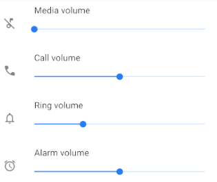

If you own an Android phone and are interested in helping me, please navigate to Settings → Sounds. Here, you will find the volume controls (in some phones, you will have an option "Volume" under which you will find all the controls). Please give me the following: a screenshot of the volume sliders (or a description, whichever is convenient for you), your device model and Android version.
Why I need this:
The volume keys in my phone (a Samsung Galaxy On7) are malfunctioning. I decided to write an app that will have all the volume controls. I will place it in my home screen and thus be able to quickly change the volumes instead of navigating to Settings.
Now, I found that volume control in Samsung differs from original Android image provided by Google. In Samsung, there are separate sliders for Ringtone, Notification and System streams, while in the Google image, these three are clubbed together under "Ring volume":
I don't know about other devices.
When I am coding an app, it will be useless to write something that works on Samsung and not on other devices. With the information you provide, I will be able to customize my app such that it supports as many devices as possible.

@mcastillo356 and @berkeman thank you for the information. Can you provide one more information: if you drag the ringtone volume slider to 0 (and thereby put your phone into mute or vibrate state), do the notification and system volumes also become 0? If you again increase the ringtone volume, do the notification and system volumes return to what they were before they became 0?
For me, Notification sound and Touch feedback & system go to zero.
Yes, they returned to their previous settings as soon as the Ringtone volume is non-zero.
Likes Wrichik Basu
Yes, they move simultaneously. Moving Tono makes Táctil y Sistema and Notificación also 0. And when I restore Tono, it starts to sound until I agree. I move the Tono from the maximum to 0, and from 0 to the maximum, and the other two move the same by themself.
Likes Wrichik Basu
I programmed a test to distinguish between the two types of volume control.
In Android, it is possible to programmatically control the ringtone, notification, system, media, voice call, and alarm streams separately. We are interested only in the first three.
The test goes somewhat like this: first, initialize all the volumes to some number, say 1. Then, take up a particular stream (say ringtone) and change its volume to some number other than 1. Now, check whether the volume of the other two streams have changed or are still at 1. If they have changed, increment a counter. Next take up the other two streams and do the same with them.
At the end, if you find that on changing the volume of one stream the other two change automatically, you may conclude that it is the Google-type configuration (as shown in the picture in the OP). Otherwise, the three streams can be controlled separately.
This test successfully works in the emulators and my Samsung device, but it has to be tested further on physical devices to conclude that it works everywhere.
