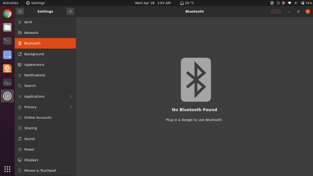

My laptop is running Ubuntu 20.04, always up-to-date.
This problem has started very recently. Suppose I connect my Bluetooth earphone to the PC, and start watching some lectures on YouTube. (Internet is provided by USB tethering from Android phone.) Suddenly, the audio on the earphone stops. On opening Settings, I find that the audio output device has shifted to Inbuilt speakers. The Bluetooth earphones are still connected, but when I try to change the audio device, the Settings app freezes, and I have to force quit it.

Nothing works. When I restart the laptop, sometimes the problem is fixed temporarily, and then it starts again after some time. On the other hand, sometimes Ubuntu fails to locate any Bluetooth hardware, and Settings says, "Plug in a Bluetooth dongle to use this feature". Rebooting continuously solves this feature.

On the motherboard. As I said in the OP, when I reboot, sometimes Ubuntu fails to find the Bluetooth. Rebooting again and again till the problem fixes is the only solution I have found.

Found now that Bluetooth is back (without rebooting). Could connect to the earphones too.
Code:
~$ bluetoothctl list
Controller 48:5F:99:BD:35:08 PC-name [default]
~$ bluetoothctl connect 00:11:5A:00:48:7D
Attempting to connect to 00:11:5A:00:48:7D
[CHG] Device 00:11:5A:00:48:7D Connected: yes
Connection successful
But this is most probably temporary, and the problem will recur.

Wanted to update that it's been quite some time since I have last faced this problem. I don't restart my laptop often, but even if I do, the Bluetooth module is properly loaded by Ubuntu. I don't know how this was fixed, but most probably it existed for some time, and then got fixed after some system update.
