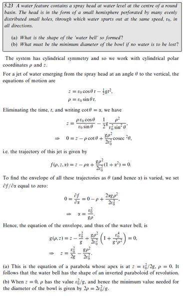

This question is about finding the smallest bowl to contain all the water being spurt out of a water spray head.

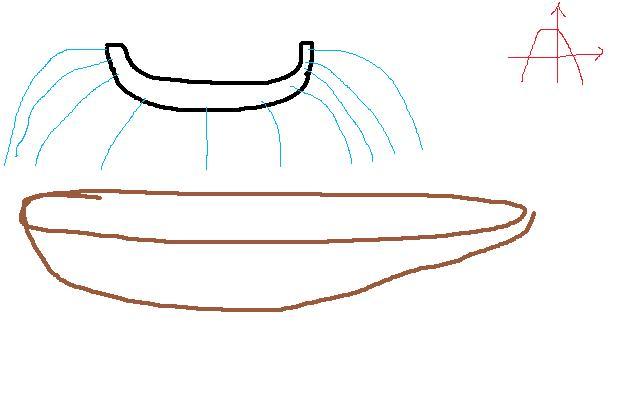

They used the lagrange multipliers to solve it which I understand, but the the envelope doesn't look like a parabola to me??
Isn't the envelope supposed to be a curve that is parallel to a certain point on every member of a family curve?
I don't even see how it's possible to draw a curve that's tangential to all water-jet curves..
  • Printed textbook page, problem 5.23, about a water spray head emitting jets from a hemisphere, with a worked solution deriving the envelope equation z = v0^2/2g - gp^2/2v0^2 for the water bell.

  • Hand-drawn sketch of a family of blue water-jet curves fanning out from a black U-shaped spray head above a brown bowl-shaped envelope curve, with a small red parabola sketch at top right.

They did not use Lagrange multipliers. An envelope of a family of curves F(x, y, p) = 0, where p is parameter, is obtained by [itex]\frac {\partial F} {\partial p} = 0[/itex], which is what they do.
Your picture is very strange. You seem to have water coming from a head that is convex downward and raised above the surface of the water. The situation described in the post has a hemispherical (convex upward) head at the level of the surface of the water.

LOL i thought it was the bottom hemisphere. That was the first picture that came to my mind when i thought of a tap and a basin (come on, who builts a tap that spurts upwars? :P)
I finally see it, thank you!
I seem to lack the imagination.

Well, who builds a water feature with a spray head at water level, pointing down?
RGV
Think of it not as a "tap" but as a fountain in an outdoor pool.
