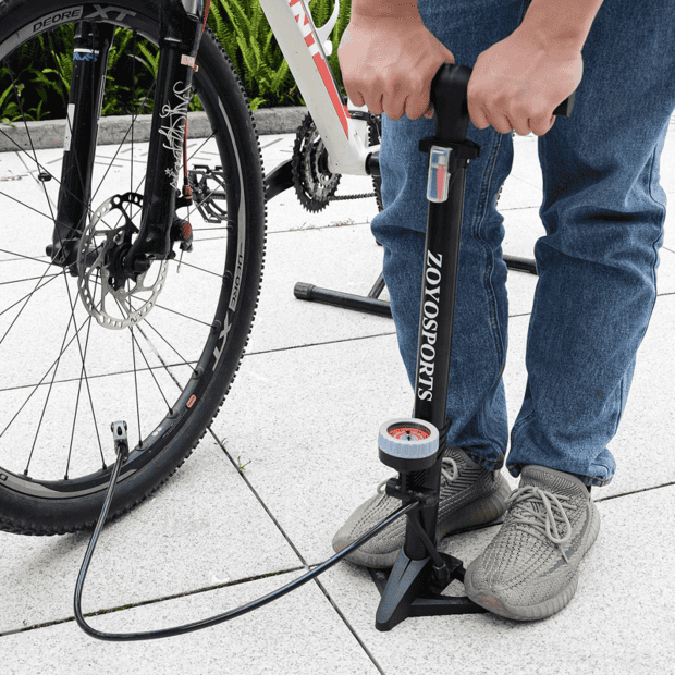

No need to buy much, do you ride bicycles? Do you already have a bicycle floor pump? If not, do you have any neighbors or friends who have one? You could probably prototype this pretty easily with a 2 quart container that you fit a bicycle tire valve to and try a few different drain hole sizes... :smile:

Thats an even better approach!

Sweat equity. Pump it up! :smile:
