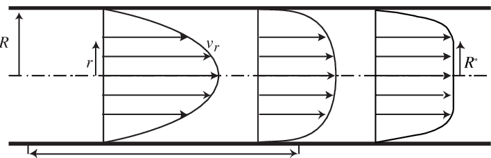

The profile of flow is usually a parabola with the center/vertex being faster than the outside.
The diagrams in Post #2 are for flow through a round tube with no obstructions. They show laminar flow on the left and fully developed turbulent flow on the right.
Flow through packed beds is different because it is controlled by the packing, and not (or barely) affected by the tube wall. If you search flow through packed bed, you will find a lot of good information. If the holes are evenly distributed, one would expect equal flow through each hole. If some holes are farther apart, one would expect more flow. But not a lot more.

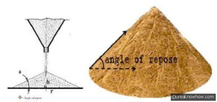

Another factor to consider is the possible uneven packing of the powder inside the porta-filter, which could be greater by the middle section of the powder volume than closer to the walls.
It is possible that manual packing of the granular material cannot fully compensate its natural critical angle of repose.
