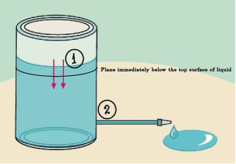

Instead of directly considering a plane where the top surface of the water lies, consider a plane that is fixed in place a small distance below where that surface starts.
Would you agree that the continuity equation applies between this surface and the egress hole?
jbriggs444 said:
Fair enough.
Let me make a small drawing of the plane you mention.
Yes, continuity would apply to the plane immediately below the one from where the water begins to flow.

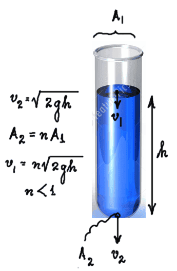

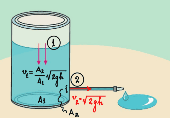

There is a way out of this, if I am right in what I write below.
Let us calculate the efflux velocity (initially at ##t = 0##) ##v_2## using the more reliable method of Bernoulli's theorem. The well known answer is ##v_2 = \sqrt{2gh}##. This gives the velocity at the open (top) surface ##A_1## as ##v_1 = \frac{A_2}{A_1} \sqrt{2gh}##. Hence, assuming ##A_2 \lll A_1##, ##v_1 \approx 0##. The diagram alongside shows my calculations.
Note, the crucial approximation in the end. In the event the top and bottom areas (##A_1\; \text{and}\; A_2##) are comparable, as the case will be if we made the same hole at the bottom of a glass tube of the same height as that of the tank, the starting velocity at the top ##v_1## would be comparable (though smaller) to ##v_2##.
I make a diagram of a test tube containing water. Note the open area ##A_1## of the test tube is much less than that of the tank but the hole area at the bottom ##A_2## is the same. The two velocities are comparable.
The way out of what? I don't understand what you have shown by invoking the Bernoulli equation. The Bernoulli equation is a statement of conservation of mechanical energy per unit volume in the case of an ideal incompressible fluid. The continuity equation is a statement of mass conservation, namely that if μ mass per unit time (kg/s) of fluid flows through area A1, the same μ kg/s of fluid must flow through area A2 under the assumption that the fluid is completely rigid and incompressible. I think it is safe to answer the question under this assumption.
I started this thread with a doubt. Is the continuity equation applicable for an open tank filled with water and a hole in the bottom? How can it be, for it will mean the velocity of outflow ##v_2 = 0##, as, supposedly, ##v_1 = 0##, the velocity at the top surface of the liquid. This assumption seemed reasonable because the top surface of liquid is at rest initially. But clearly something is wrong here because we know ##v_2 \neq 0##.
I have since progressed to understand that yes the continuity equation is valid for this situation, but that ##v_1 > 0##, contrary to what I felt earlier. My last post is an attempt at clarifying the matter.
