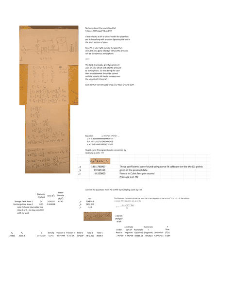

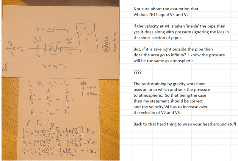

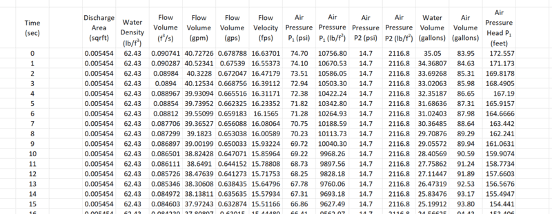

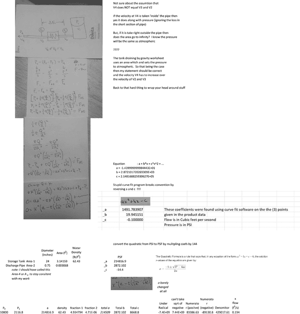

New member here. As the title states I am trying to solve the flow volume of water from a pressurized storage tank through a heat exchanger and then discharging out the end of a pipe. I have been working on this for several days now without any luck, seems like now I am just throwing equations at it and hope something sticks. So I could use a nudge in the right direction.
The storage tank is a bladder tank in that air pressure is one side of the bladder and water on the other.
From the bottom of this tank the water flows through a heat exchanger. All I have on the heat exchanger to work with is (3) data points relating change in pressure with flow rate. I used curve fitting software to come up with a quadratic equation to describe this.
The water exits the heat exchanger and just empties into the open.

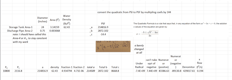

I have been using Bernoulli’s Equation to try and solve this. All my units should be a match. Volume in cubic feet, Area in square feet, pressure in pounds per square foot, density in pounds, time in seconds. Attached is a spreadsheet of my latest attempt. I apologize for how messy it is.

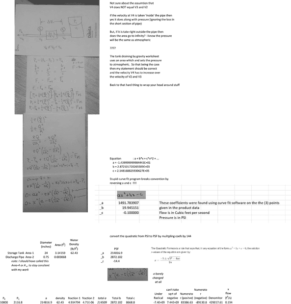

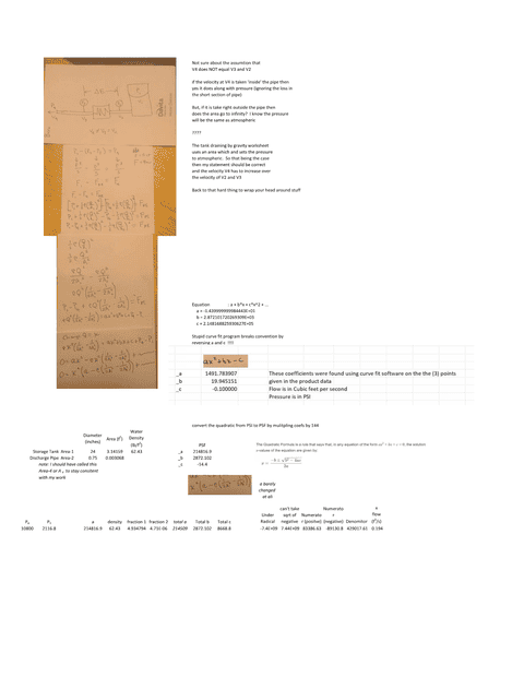

Gotcha. Didn't think about that. The only way I could do some of the math easily is using excel.. But here is a PNG file of my work
Put it right in the body of the response using the "insert image tool" (it looks like a little picture). It's too small to see (for me at least).
Try this one
AxisCat said:
Try this one View attachment 330525
hmmm, only a marginal improvement. Can you break it up into a few images? 1 for the diagram, 1 for the math, etc... they can all be inserted independently in the same way.
Still having trouble getting the resolution right, Third time??
:olduhh: Sorry, no better. You are going to have to break it into a few separate images.
The website is compressing my image files to a point they are too hard to read... let me try something else

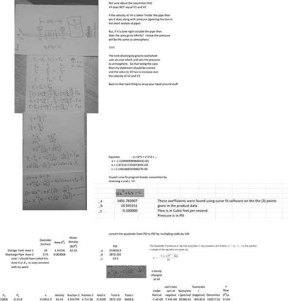

Incompressible flow, uniform properties across the pipe,is the pipe the same diameter at 3 and 4?
erobz said:
Incompressible flow, uniform properties is the pipe the same diameter at 3 and 4?
Correct on the statement and the diameters are the same
I am not a student... not really in the math field. My algebra and physics was about 30 years ago.

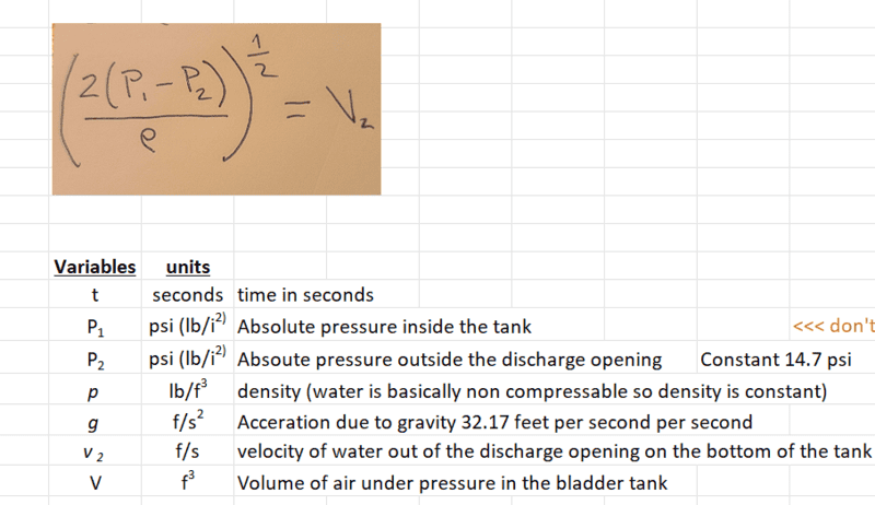

The pressure inside the jet, just outside the pipe almost immediately goes to atmospheric pressure. So ##v_4## is the jet velocity, and you can apply conservation of mass (continuity) to find ##v_3##. What do you get for ##v_3## if the cross sectional areas of 4 and 3 are the same?

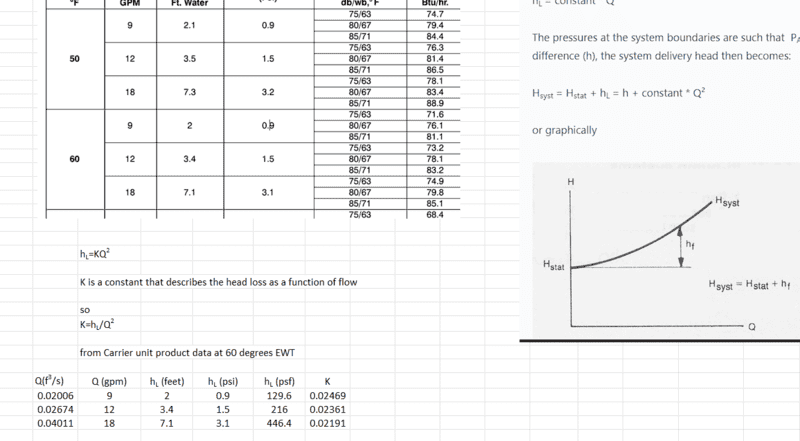

You should not be using the Bernoulli equation, since the pressure drop in the heat exchanger is mainly frictional pressure drop. Please show us the exact pressure drop vs flow rate data points you have.
In your calculations, I hope you recognize that pressure is in lbs force units and density is in lbs. mass units, and that you are using ##g_c=32\ \frac{lb_m\ ft}{lb_f\ sec^2}##
Are you just trying to add the pressure drop in the final discharge pipe and the gravitational heat in the tank to the pressure drop in the heat exchanger? What is the layout of the heat exchanger: single pass vs double pass, shell side vs tube side, tube diameter, number of tubes, total flow rate, etc.?

The pressure inside the jet, just outside the pipe almost immediately goes to atmospheric pressure. So ##v_4## is the jet velocity, and you can apply conservation of mass to find ##v_3##.

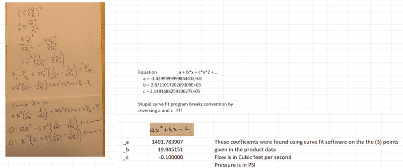

That makes sense. So looking at how I set up my equation does it look right? The quadratic I am using is from curve fitting the pressure drop as a function of flow. I am not sure I can just set this equal to the change in pressure between point 4 and 1. And I don't know if it was correct to substitute the velocity by a volume/sec?

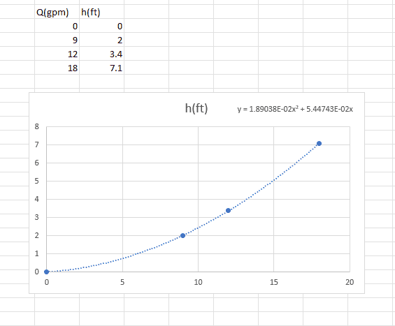

This is all the data i have on the heat exchanger, it is a single pass tube inside of a tube. Refrigerant on one side, water on the other. It is a ground source heat pump.
Intuitively I know the pressure drop in the heat exchanger is due to friction I guess I was hoping I could convert it to just pressure drop as a function of flow and then use the Bernoulli equations...
It doesn't look great. You should basically have a quadratic curve passing through the origin. i.e ##\Delta P(Q) = \beta Q^2 ## meaning if there is no flow there is no loss between points 2 and 3. You should be trying to force that form.

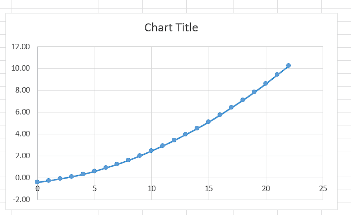

Right, it was close to passing through the origin, i think rounding got it off some.
AxisCat said:
Right, it was close to passing through the origin, i think rounding got it off some.View attachment 330536
format the trendline for your original data, and set the origin to 0 for good measure.

Right... if i can loose the b and c coefficients it would be even simpler and just be (k)Q^2. but the K factor seemed to change with flow
Exactly what you posted ΔP(Q)=KQ^2

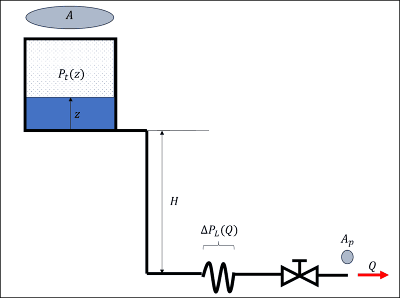

My goal is to determine a flow rate through this system based on a pressure inside the tank. As time moves forward the pressure in the tank will decrease along with the flow until the pressure inside the tank is equal to atmospheric pressure. I am trying to model that over time
There is what I get, it doesn't perfectly fit theory, because that linear term isn't negligible.

Its a trivial data point, you don't have to add it. You can just set the intercept to zero under formatting the trendline options.

Unfortunately, not such a trivial model to tackle... Also, all of the components have losses, not just the heat exchanger.
