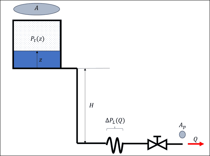

So you are trying to determine how long the storge tank will take to deplete to some minimum capacity when someone opens the tap?
Not really... the storage tank just keeps the water pressure between 60 and 40 psi. And with the 35 gallon draw down a tap can be open for quite a while before our pressure drops below 40 and the pump cycles back on. My unit will drain the tank in 3 minutes (roughly) before the pump cycles back on. A 5 hp pump draws more power than my entire unit. On any HVAC unit you want to maximize run times for effiecency and comfort. I don't want to short cycle the pump and need to be sure the pumping costs will not be more than my heating and cooling cost to operate.

Ok, so you want to find the volumetric flowrate vs time. If you did the experiment in a reasonably controlled manner with reasonably precise measurement equipment, then my guess is the linear factor in the trendline fit for the heat exchanger is probably due to the fact that the loss coefficient for a pipe of fixed properties depends on the Reynolds number, which depends on the flow velocity...i.e. it generally is not a constant as flow changes, perhaps your experiment has captured that reasonably well over the measure range of flows.
If you want to look at the transient behavior its basically a second order ordinary differential equation. Is it something you are interested in, I'll produce it under some simplified assumptions?

Here is what I'm coming up with for the EOM ( assumes uniform properties distributed across any particular section - that approximately the case for turbulent flow )
$$ P_t(z) + \rho g \left( H + z\right) + \frac{1}{2} \rho \dot z ^2 = \rho \left( l \frac{A}{A_p} + z \right)\ddot z + P_{atm} + \frac{1}{2} \rho \left( \frac{A}{A_p} \right)^2 \dot z^2 + \Delta P_L(Q) $$
Then from continuity you have:
$$ Q = -A \dot z \implies \dot Q = -A \ddot z $$
So you can sub that in and get a first order nonlinear equation mostly in terms of ##Q## and its derivative. There is still a ##z## buried in the pressure function to contend with, but with regards to a numerical solution its not an issue. Just note that:
$$ z = z_o + \int \dot z dt = z_o -\frac{1}{A}\int Q dt $$
The pressure function in the tank ##P_t(z)## is a thermodynamics problem, I'd go with adiabatic expansion of an ideal gas, but I would defer to @Chestermiller for the theory on that.
Also, I left the loss function ##\Delta P_L(Q)## general for now. You should be able to get away with either what you(or I) polynomial curve fit, or the power law fit Chester suggests. If you want to include the loss characteristics of other components, it's not too late for that.
## l ## is the length of all the plumbing from the tank to the exit.
Anyhow, you put ##z## where you want it initially, specify the initial condition in the gas, set the volumetric flow to zero and start the clock using standard numerical integration techniques.
The derivation was long winded, so if I've bungled it, and or anyone wants to examine it...let me know.
$$ \rho \left( l \frac{A}{A_p} + z \right)\ddot z + P_t(z) + \rho g \left( H + z\right) + \frac{1}{2} \rho \dot z ^2 = P_{atm} + \frac{1}{2} \rho \left( \frac{A}{A_p} \right)^2 \dot z^2 + \Delta P_L(Q) $$
Wow! That looks like what I was trying to arrive at. I will need to dissect this and try and understand all the bits and pieces. Especially the calculus which is a big weakness of mine. I have a couple of busy days coming up but I hope I can reach back out to everyone after I get some time in working on it.
