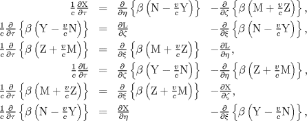

In his seminal paper on relativity, On the Electrodynamics of Moving Bodies, Einstein makes everything in the primed frame prime when utilizing Maxwell's equations:
The E and B components (or F in Rohlf's example) are transformed in the manner I brought up in #4:
