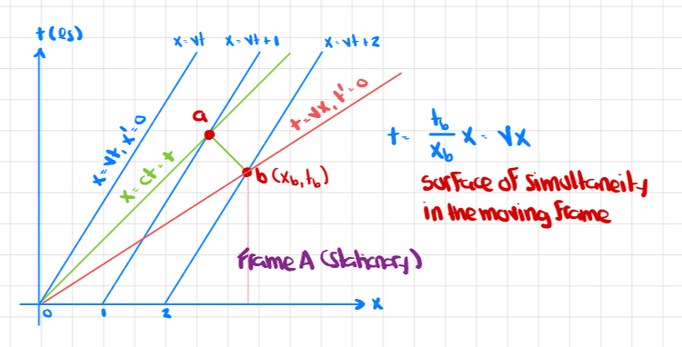

I'm going to post here my exact calculations to reach these equations.
I started with a stationary frame A (coordinates x and t) and a moving frame B (coordinates x' and t', with three railcars)
Spacetime diagram in frame A with t on the vertical axis and x on the horizontal axis, showing blue lines x = vt, x = vt + 1 and x = vt + 2, a green line x = ct, a red line t = vx, and points a and b with a red line t = (t_b/x_b)x = vx labelled surface of simultaneity in the moving frame.
From this scenario we conjecture a transformation of the form

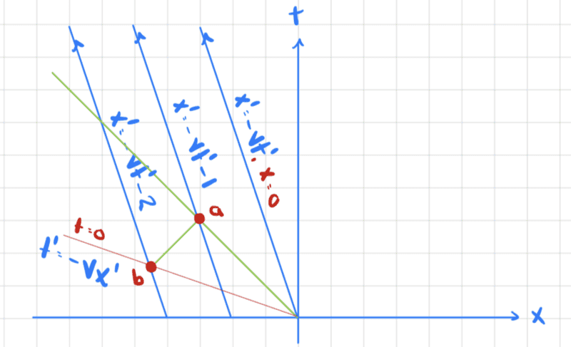

But then what if we think about frame B being stationary and the three railcars being in frame A (which is now moving relative to frame B). We have
Spacetime diagram with horizontal x axis and vertical t axis; three parallel blue worldlines slanted, labelled x'=0, x'=v and x'=2v, with a green light ray from the origin, a red line labelled t'=0 and t'=-vx', and points a and b joined by green segments.
Here are the calculations to find points a and b

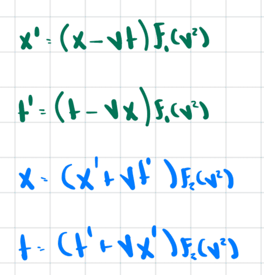

At this point, taking into consideration the four equations that we have conjectured, we have
Four handwritten equations: x' = (x - vt)F1(v^2), t' = (t - vx)g1(v^2), x = (x' + vt')F2(v^2), t = (t' + vx')g2(v^2), with the first two in green and the last two in blue.

And now if we solve for ##f_1## or ##f_2## we obtain
Handwritten derivation in green and blue ink on grid paper, solving for the factors F1 and F2 in terms of v, ending with F1 F2 = 1/(1 - v^2).
One option is to say ##f_1=f_2## and then we obtain the usual Lorentz transformation.
But can we not choose other functions?
For example suppose ##f_1=1## and ##f_2=\frac{1}{1-v^2}##. Then we get
