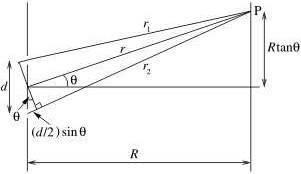

I have attached a diagram showing all the basic parameters used:
[3] [tex]r_1 \approx r - d/2(sin \theta); \; r_2 \approx r + d/2(sin \theta)[/tex]
This approximation is based on R>>d and the derivation continues based on Huygen’s theory, where the slits are 2 sources of light having equal amplitude and phase, which meet in superposition at a given point [P] defined by [tex][ \theta][/tex]
[4] [tex]\Psi = A exp \; i \left[ k \left( r- \frac{d}{2}sin \theta\right) – wt \right] + A exp \; i \left[ k \left( r+ \frac{d}{2}sin \theta\right) – wt \right][/tex]
[5] [tex]\Psi = A exp \; i \left( kr-wt\right) \left( exp \left[ ik \left( \frac{d}{2} \right)sin \theta \right] + exp \left[ -ik \left( \frac{d}{2} \right) sin \theta \right] \right)[/tex]
[6] [tex]\Psi = A exp \; i \left( kr-wt\right)*2 cos \left[ k \left( \frac{d}{2} \right)sin \theta \right][/tex]
As far as I can see, the step from [5] to [6] is based on [2], which seems to suggest that we are only dealing with the `real part` of the complex wave function? However, the derivation then goes on to point out that the square of this wave function, i.e. [6], corresponds to the intensity (I) of the resulting superposition wave, but then only equates (I) via proportionality to part of [6]:
[7] [tex]I \propto 4A^2 cos^2[k(d/2)sin \theta][/tex]
If we are only dealing with the `real part` of the complex notation, why can whole of [6] be converted by into a trigonometric form via applying [2] as follows?
[8] [tex]I = \left( Acos(kr-wt) * 2 cos \left[ k \left( \frac{d}{2} \right)sin \theta \right] \right)^2[/tex]
On the basis that all the variable parameters are driven by the position [P], then the main parameter is [tex][ \theta][/tex] and we should be able to plot the intensity across the screen by setting the other parameters in [8] to relative values as follows:
[tex]A=1; R=1; r = Rsin \theta; d=0.001; k=2 \pi/500nm; t=0[/tex]?
Therefore [8] becomes:
[9] [tex]I = \left( cos[(2 \pi/500*10^{-9})Rsin \theta] * 2 cos \left[(2 \pi/500*10^{-9})) (0.001/2)sin \theta \right] \right)^2[/tex]
Unfortunately, plotting [9] against [tex]\theta[/tex] doesn’t seem to produce the expected alternating constructive/destructive interference intensity, so I must assume that I have made an error or wrong assumption. I realize that this post may be too involved to interest anybody, but any insights by somebody who understands both the maths and physics would be appreciated. Thanks
No, it doesn't. [itex]\cos \theta = (e^{i\theta} + e^{-i\theta})/2[/itex] is simply being used as an identity here.
It may help to take your step [8] and rearrange it slightly:
[tex]\Psi = \left( 2 A \cos \left[ k \left( \frac{d}{2} \right) \sin \theta \right] \right) e^{ i ( kr - \omega t)}[/tex]
The complex exponential at the end gives the (complex) oscillating aspect of [itex]\Psi[/itex]. The big parentheses in the front enclose the (real) amplitude of that oscillation. To get the probability density at the screen we use the usual rule [itex]P = \Psi^* \Psi[/itex]:
[tex]P = {\left( 2 A \cos \left[ k \left( \frac{d}{2} \right) \sin \theta \right] \right)}^2 e^{ -i ( kr - \omega t)} e^{ i ( kr - \omega t)}[/tex]
The two exponentials multiply to give 1, and the rest gives you the probability which varies with position on the screen. So in this case, we don't use the "take the real part" trick at all. The relationship between the QM wave function [itex]\Psi[/itex] and the probability density P is guaranteed to give you a real P from a complex [itex]\Psi[/itex].
The pattern on the screen is easier to "see" if you call the position on the screen y, instead of [itex]R \tan \theta[/itex], and use the small-angle approximation:
[tex]\sin \theta \approx \tan \theta = \frac{y}{R}[/tex]

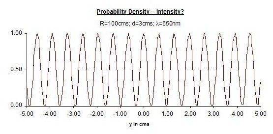

jtbell said:
Set [itex]\theta = 0[/itex] and you get [itex]P = 4A^2[/itex]. This corresponds to what you see at the center of the screen in the classical Young's experiment: the intensity with both slits open is four times what you get with only one slit open. In the QM case, the particle is four times as likely to arrive at the center of the screen, with both slits open, versus with only one slit open.
That makes sense, however I would expect the probability of individual photons hitting the screen to continue fall as the angle [itex]\theta[/itex] or [y] is increased. As such, successive bands of constructive interference have less `intensity` due to the lower probability density as [y] is increased. This is the bit that I having problems with as far as the following equation is concerned:
[1] [tex]P = {\left( 2 A \cos \left[ k \left( \frac{d}{2} \right) \sin \theta \right] \right)}^2[/tex]
If I normalise the terms [itex]4A^2=1[/itex], then the maximum intensity at the centre will be unity and we are left with just the [tex](cos(x))^2[/tex] function, where we might approximate [x] for small angles as follows:
[2] [tex]x = \frac{kd}{2} * \frac {y}{R} = \frac {\pi d}{\lambda} * \frac {y}{R}[/tex]
I am assuming the cos(x) function oscillates between [+1] and [-1], which when squared is normalised to [0] and [+1]. Therefore, although the cosine function would suggest alternating bands of probability density [P], the intensity doesn’t seem to fall as [y] is increased, only cycles between the max and min value?
As a reference point, I considered the difference in the paths associated with each slit as a function of the angle, i.e.
[3] [tex]r_1-r_2 = d sin(y/R)[/itex]<br /> <br /> A value of [d=3cms] and [R=100cms], the difference in the path length would be 1.5mm at an offset of [y=5cms]. Of course, I am assuming this difference has to be put into the perspective of the wavelength, i.e. red light=650nm. As such, the granularity of incrementing [y] affects any graph plotted, which I believe was the root cause of some of the strange results, but I have attached one that appears to reflect that while [P] oscillates it doesn’t fall off as a function of [y], which I still don’t understand. Sorry, to belabour the point, but it seems important to any subsequent understanding. Thanks[/tex]

mysearch said:
I understand your comments concerning the classical versus quantum view. However, would it still be correct to equate intensity (I) with the probability density [P] as the number of photons of a given energy (hf) per square metre per second?
Yes, although I would say "proportional to" rather than "equal" because the units are different. Intensity has units of energy / (area . time) whereas probability density has units of 1 / (area).
Yes, successive interference maxima should really become smaller as you move away from the center of the interference pattern. Our equation for P doesn't show this because of the approximation in step [3] of your original post, which is valid only for smallish [itex]\theta[/itex].
[added] There's another approximation which is more important: the original assumption that the individual waves are of the form
[tex]\Psi = A e^{i(kr - \omega t)}[/tex]
This is a plane wave with flat wavefronts, whose amplitude remains constant. Actually, the waves from a finite source diverge, with curved wavefronts, and their amplitude decreases as they move away from the source. From a point source you get a spherical wave that goes like
[tex]\Psi = \frac {A_0} {r} e^{i(kr - \omega t)}[/tex]
So if you have two small pointlike holes instead of two slits, you have to find
[tex]\Psi = \frac {A_0} {r_1} e^{i(kr_1 - \omega t)} + \frac {A_0} {r_2} e^{i(kr_2 - \omega t)}[/tex]
If the distance between the holes (d) is much smaller than the distance from the holes to the screen, you can still use your equation [3] as a good approximation for [itex]r_1[/itex] and [itex]r_2[/itex], but the sum is still a lot messier than with plane waves.
For long narrow slits you have to use cylindrical waves, which I think go like
[tex]\Psi = \frac {A_0} {\sqrt{r}} e^{i(kr - \omega t)}[/tex]
OK. I can go back to this point, at a later date, now that I understand the basic problem. I think I also understand the implications of the points you have made about plane and curved waves, i.e. if we apply Huygen’s principle, then the actual distribution of photons/waves from the source depends on the shape of the source, e.g.
