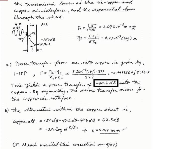

Hello
Here is a problem of Pozar's Book(mircowave).
Text problem 1.8: A plane wave at 1 GHz is normally incident on a thin copper sheet of thickness t. (a) Compute the transmission losses, in dB, at the air-copper and copper-air interfaces. (b) If the sheet is to be used as a shield to reduce the transmitted wave by 150 dB, what is the minimum sheet thickness?
and here is solution:
Handwritten worked solution for a microwave problem: reflection coefficient from air into copper, power transfer of -40.6 dB boxed, copper attenuation 68.8 dB, and t = 0.017 mm.
my problem is I don't know how he obtain -40.6 because
|T|^2 (T is Reflection Coefficient ) is return power and 1-|T|^2 is transfer powe but 10log none of them return -40.6 , what does -40.6 and how can calculate it?
##| \Gamma|^2 = .999956^2 + .0000435^2 ##
## 1 - | \Gamma|^2 = 8.7996e-005##
## 10 log_{10} (8.7996e-005) = -40.6 ##
Perhaps it was the modulus of the complex number that threw you off? Or was it the base10 log?
