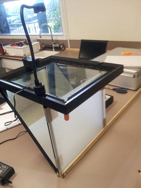

For an experiment involving a ripple tank and a wave monitor, the frequency was changed from 10Hz to 100Hz and it was found that at precisely 66.7Hz, the wave produced appeared (to the viewer) to be standing still. At any value below 66.7 Hz the wave moved inwards, and at any value above 66.7Hz the wave moved outwards. Is there an explanation for this (based off theory) ?

Hello emie. I'm assuming that you had fluorescent lighting in the room and that the frequency of the mains was 60Hz or thereabouts. If so you were probably observing the stroboscopic effect.

The waves were lit with a hanging light that was hung (approximately) 10 cm above the waves.
Here's a photo of the experiment:
The lights in the room weren't on as it was daytime.

Try with just plane waves instead of the interference setup - try without the small light on, and add damping between the mirror and it's supports.
No I don't think that the motor vibrates the mirror.

I'd start out by using a different light-source.
Use a battery-powered lamp instead, say.
Then look for other sources of vibration.
Also simplify the experiment ... see what you have to do to remove the effect - then you have your cause.

So if I used a battery powered lamp (at a different frequency), and the waves were not standing still at 66.7 Hz, would that mean that the light source that I used before can be taken into account for being a part of the matter?
If a new lamp removes the effect then it is sensible to conclude that the old lamp had something to do with it.
If nothing changes, then we can rule out the lamp.
A mains-powered lamp usually has a slight flicker close to the mains frequency (or twice that).
A DC lamp - i.e. run off a battery - should not have this flicker.
If removing the flicker removes the effect, then it is sensible to conclude that the flicker was the cause.
Thus the change to a battery-powered lamp. A flashlight should do.
